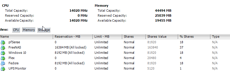

What makes you use a separate VM for Plex instead of a jail?
Didn't see a reason to bother figuring out jails when I could just spin up another VM in ESXi. I've got more RAM than I need(48gb) in the system so the extra resources don't make much difference. Also ESXi makes it easy to keep Plex from hogging so much CPU that the NAS and Firewall quit working properly. Here's my VM list:
