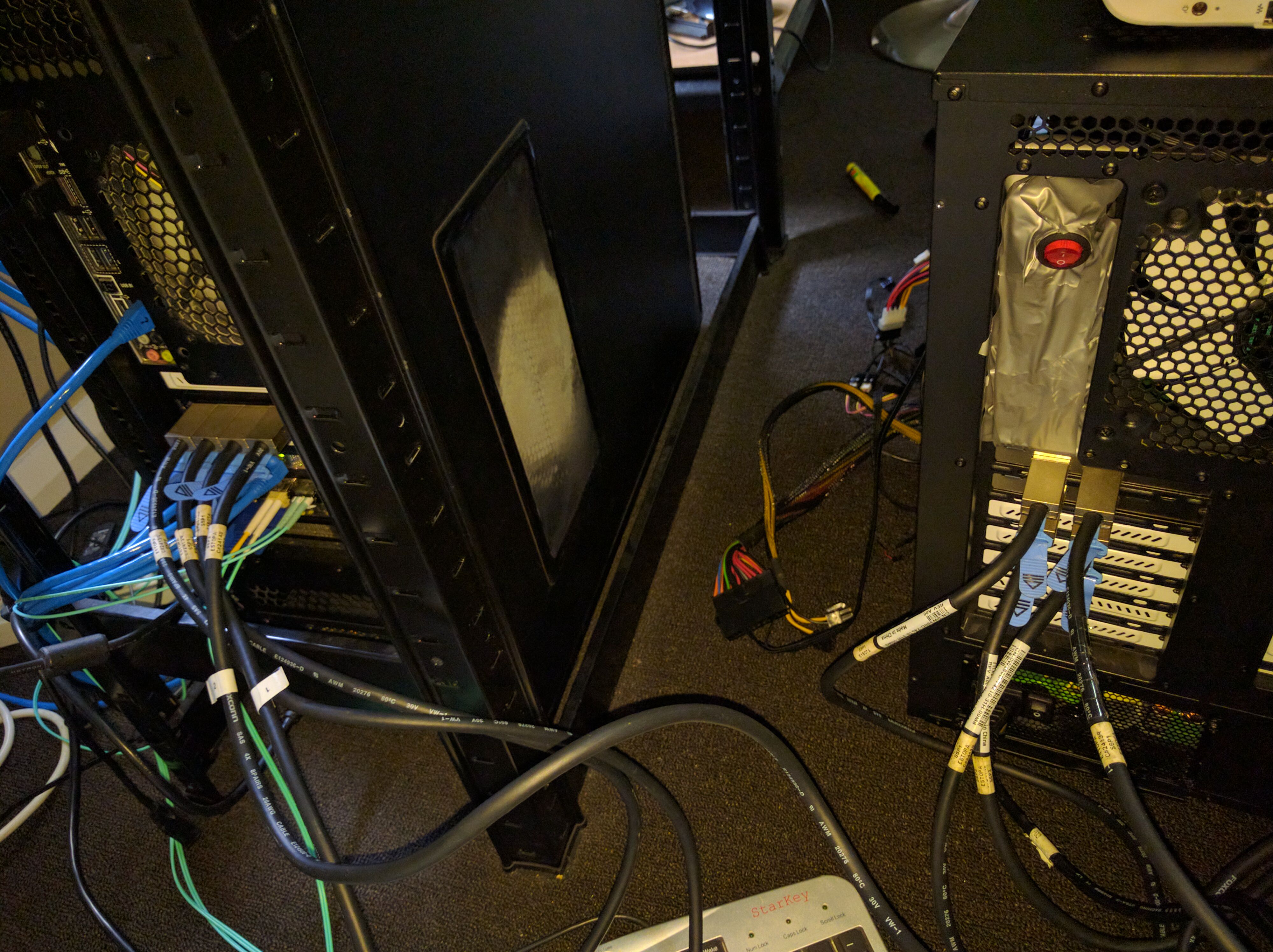

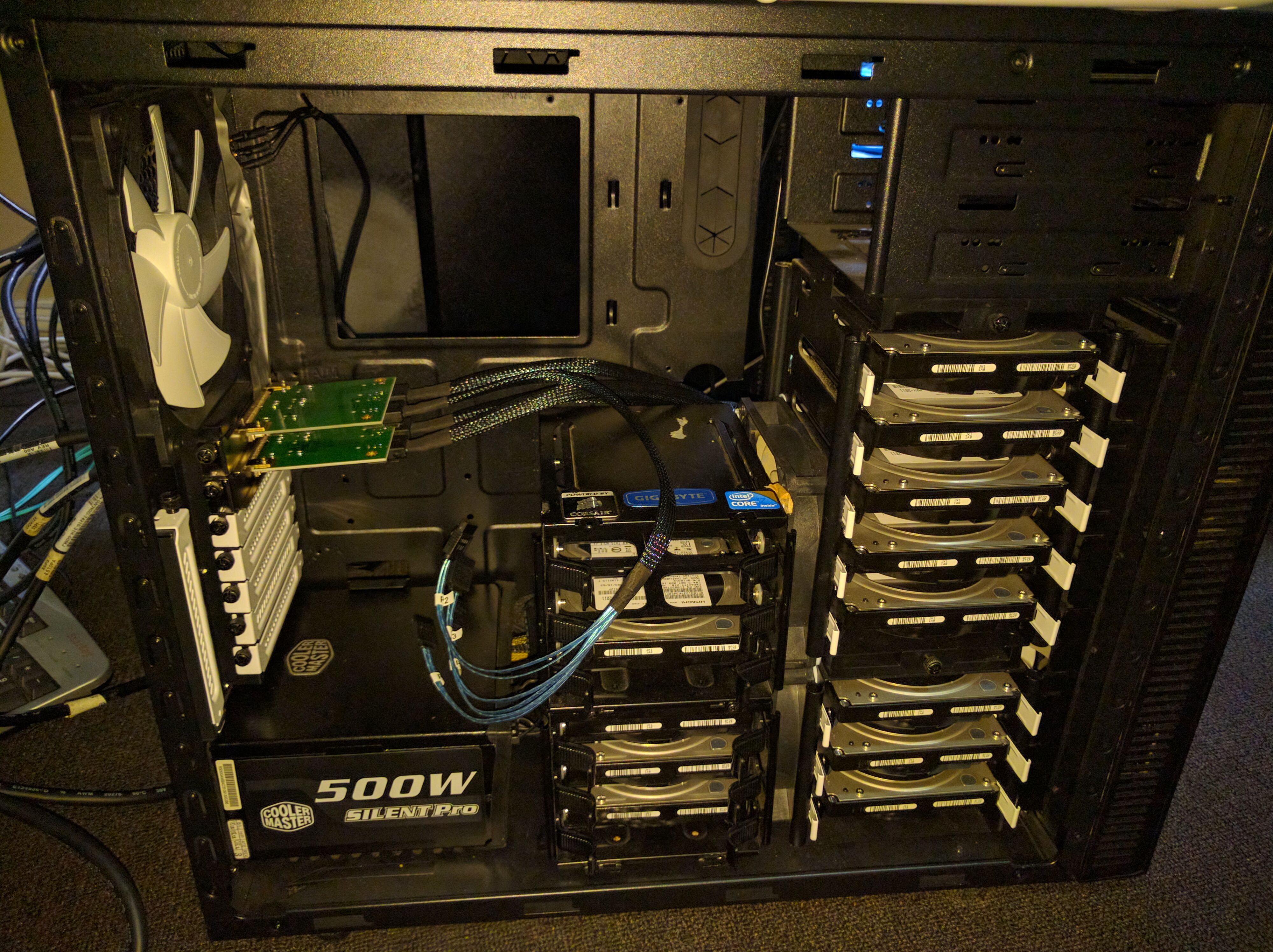

Pics anyway:
Looks like fun.
Love the situation with the power button
I couldn’t find a blank IO shield, so duct tape to the rescue.
I set it up as a big zfs pool using striped mirrors so I could move some data around and the speed seemed good. But I still haven’t made any room for it so it’s still sitting on the floor until I run out if space and need to actually use it.
