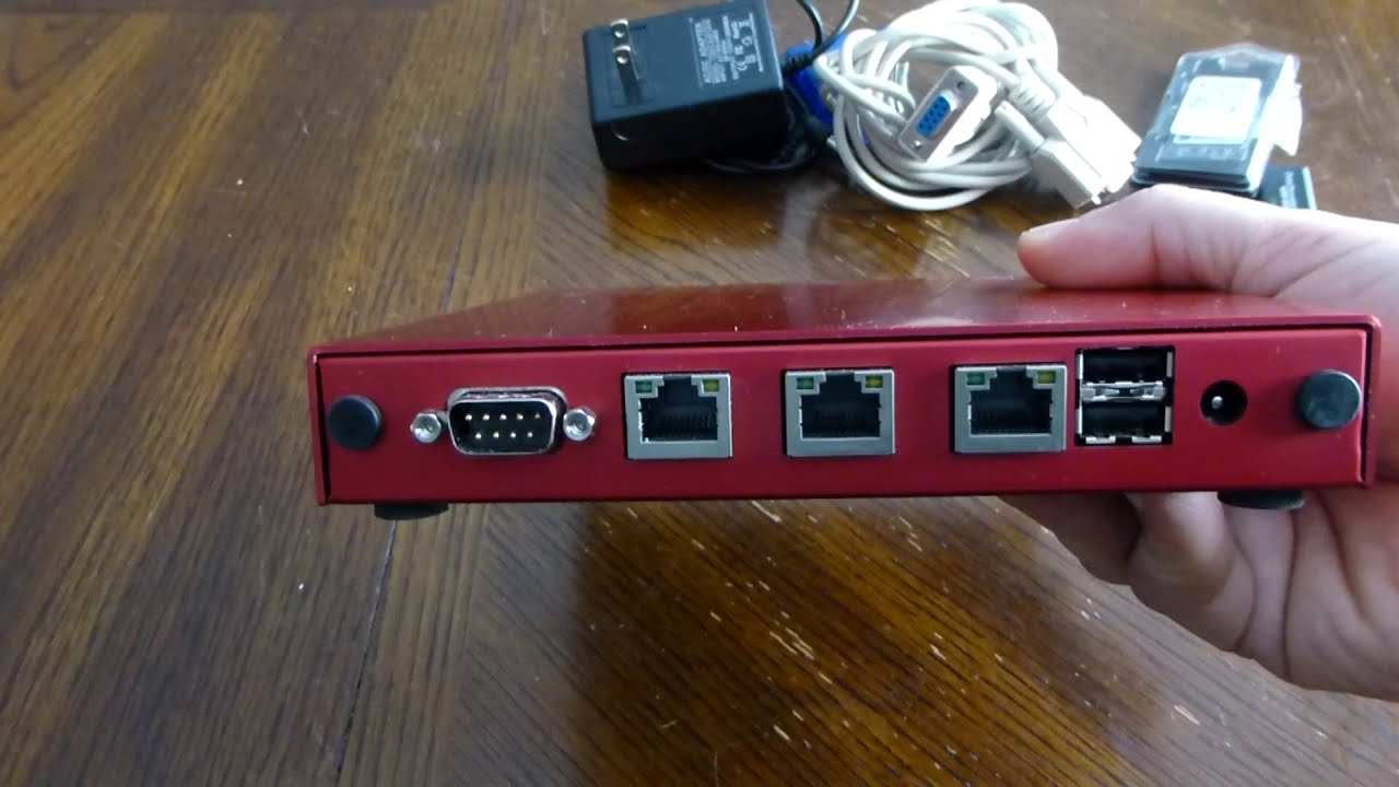

I have heard of it, but I don’t have any experience with it, so I can’t really have an opinion on it. I watch the video I attached below early this morning and I can now give you an opinion on Opensense. My opinion is you would be better off eighter setting up IPTables and packet routing in some flavor of Linux or going with Pfsense than using OpenSense. Watch the Video I attached and you will understand why.
