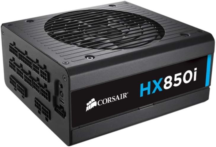

Ok I am a noob at building computers as it has taken me over a year to finish my first/current build. I am almost done and just need to get a PSU and wait for the rest of the 480's to come out.
So looking in the prime day deals i found these two psu on sale and wanted to know if these are worth the price. These may be a little over kill for current build but I plan to upgrade to better cpu later on and like to future proof as much as I can. Saying that here is my build so far. http://pcpartpicker.com/list/3kQP3F
https://smile.amazon.com/dp/B00M2UIXX2/ref=gbps_rlm_m-5_c722_eda1ee30?smid=ATVPDKIKX0DER&pf_rd_p=befd7e4e-db39-4a3b-8c7a-595fb8a4c722&pf_rd_s=merchandised-search-5&pf_rd_t=101&pf_rd_i=13887280011&pf_rd_m=ATVPDKIKX0DER&pf_rd_r=FWJC15DP4NGCDXDXTCQ2
https://smile.amazon.com/dp/B00YPNSQTU/ref=gbps_rlm_m-5_c722_249d2fd3?smid=ATVPDKIKX0DER&pf_rd_p=befd7e4e-db39-4a3b-8c7a-595fb8a4c722&pf_rd_s=merchandised-search-5&pf_rd_t=101&pf_rd_i=13887280011&pf_rd_m=ATVPDKIKX0DER&pf_rd_r=FWJC15DP4NGCDXDXTCQ2
That's crazy overkill. Unless you're gonna do 4 way then that 750 should do the trick. It's a nice PSU and if you're okay with the price I can't fault you. Fully modular is so nice to build with.
Ok thanks have any input of a better deal for a psu. These are just two i found on prime day and just wanted to know if the deal beats going for something smaller.
you haven listed the CPU or anything other then the 480. Guessing you going for an overclocked 480. And if you are going the two gpu draw would be 400w so 500 would be enough. 550 - 650 is where you should be looking. I recommend going modular. I made the mistake of not doing that. But now have a 1200w FSP fully modular.
