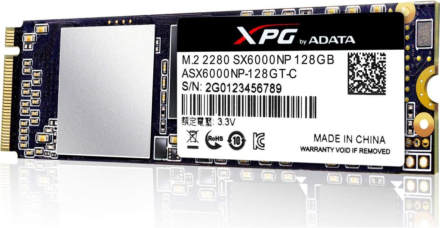

Need help deciding what SSD to buy for Gaming, Workstation, and Server Ryzen 7 1700
Ok, I have decided to purchase the Ryzen 7 1700 for my CPU and the Asrock X370 Fatal1ty Professional Gaming motherboard, so I right now I am trying to decide what two SSD’s should I purchase for this build. Keep in mind I have a max budget of $5,000 USD dollars to spend over a whole year, so remember M.2 SSD’s while quite a bit faster for the size I need would cause my budget to go way over the max amount I can spend within a year.
I have posted a link of my build for anyone willing to help me decided what SSDs I should purchase to get the biggest bang for my buck. I really like Samsung SSD but I am willing to consider other manufacturers.
The total cost for the build is a little over my max budget so It will need some tweaking, so I hope by deciding on different items that I don’t know anything about I can lower my budget to the max outlay I can afford, but I am going to do that on an item by item bases, So In this special post I am only asking for help picking SSD’s. If you have a suggestion for anything else, please post it my special build post, which I will link to here.

Buy a small m.2 nvme or simple PCIe SSD for OS and most software, buy larger SATA drive for games and the rest of the software, and then just get HDDs for pure storage.

Thanks pycho_666 for the reply, but As I explained before for my use case a small m.2 won’t work because of Windows space hungry on what every medium you uses compare to Linux. Ok, I am not just using this Computer build to run games sure the web or create youtube videos. This machine is also going to be used for Virtualization experiments where I could have as many as 4 to 8 different virtualized servers or computers running at the same time or network experiments, and I don’t want these virtualized machines to run on hard drives. Also, I plan on running Windows 10 and a Linux distribution on two separate drives. I am not going to run Windows 10 and a Linux distribution on the same disk. I would sell my right arm to be able to afford two 1GB m.2 SSDs, but I have to stick with what I can afford.

The thing is, SX6000 is faster than every SATA drive, and is priced cheaper than most of them. I mean 256GB drive is cheaper than 128 SX8000, that is crazy fast, but also crazy expensive. So there’s that.
dual 256GM drives will set you back some 170$…
You will not really save much (if anything) if you go pure SATA III or M.2 SATA III…
Most games doesnt “really” care if you’re using SSD tech or not, i mean if you invest in some rediculessly expensive ssd fast’n furious SSD you may feel a small difference, basically i felt 0% difference from the low priced samsung 7XX what ever, and replacing it with a M.2 samsung 960 EVO as boot drive.
Id just go with the tried and trued SSD boot, and mechanical storage solution.
maybe there is a few %(and it is a few %) to get by either going full SDD, or something redicules like WD black or something like it, but price to performance id say.
Slap a boot SSD, and a 2TB lower priced mechanical harddrive, maybe 2 x 1tb in raid which ever tickles your fancy.
You will be able to notice a difference, but it is no where near what it is hyped up to be, i mean do you really care if the load screen takes 5 seconds or 10 seconds?. I mean really honestly care. but those are the numbers were talking about.
All in all it really is a numbers game, pay 4 times the price for storage for your games, or live with the “lowered” readtimes, lowered being a relative term in this case.
For storage, bang/buck absolutely peaks in the low-end SSD area. I’m not so lucky as to own an nvme drive (or a mobo that supports them, even), but my $50 256 GB SATA SSD works (this is the subjective part) totally fine for me. My OS boots in a few seconds, directory listings are instant. Transferring large files is not, but it’s damn well fast enough. Also, most of the big files I might be transferring (games, movies, music, etc.) are on my HDD anyway. (This may or may not apply to you, depending on what you do with your system etc.)
If I had to rebuild my desktop from scratch, I would get two 256 GB SSDs (one for windows, one for linux) and a 2 TB HDD for storage. I install programs to the install medium (SSD), except games, which go on the spinning rust. HDD storage space will vary wildly depending on how much stuff you have, but I can’t imagine filling up a terabyte on my OS disk. Maybe 512 GB on a good (bad?) day.
Just my two cents, everyone sets up their storage differently it seems. What I’m trying to say is that you can probably get the slowest modern SSD out there and still be fine, so it’s a good place to cut costs.
