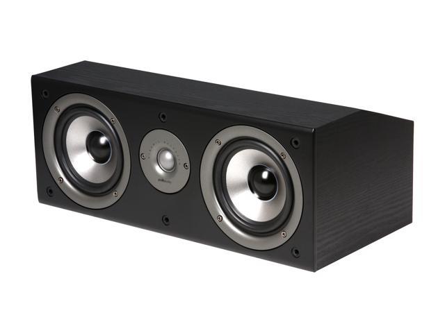

I was thinking of getting this one:
Does it seem like a decent one?
