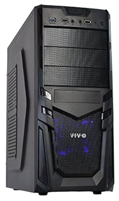

Oh yeah I forgot one last thing, will this case fit everything fine? I saw it on Amazon a few weeks ago and I really liked it
windows 10 keys are that price unless its a bulk OEM key. and i'd trust shadows build with his case over that one. i'm not too fond of cheep off brands that we don't really know about. especially a top PSU mounted case...
