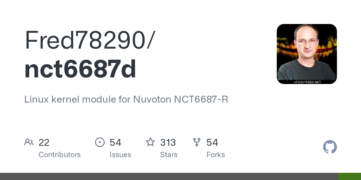

On the MSI Z690-A / Z790-P for LGA 1700 I have seen people having to use out of tree Kernel modules to get the Super IO to report correctly, have you done so before returning the board?
I have a MSI X670E Carbon and I had to install the kernel module that @ZirBlazer mentioned and then all works fine. Fedora 42.

Gigabyte tends to use ITE SIOs. The MSI board you returned uses a Nuvoton NCT6687-R Super IO chip, it is stated in the Manual.
Sensor reporting under linux is going to require a lot of manual development and tinkering. There is no consistent way to get all the data hwmon can get in Windows. Period. “Sensors!” it might work for some old piece of server gear a lot of linux devs owned, but it is not going to work for desktop components at.all.
