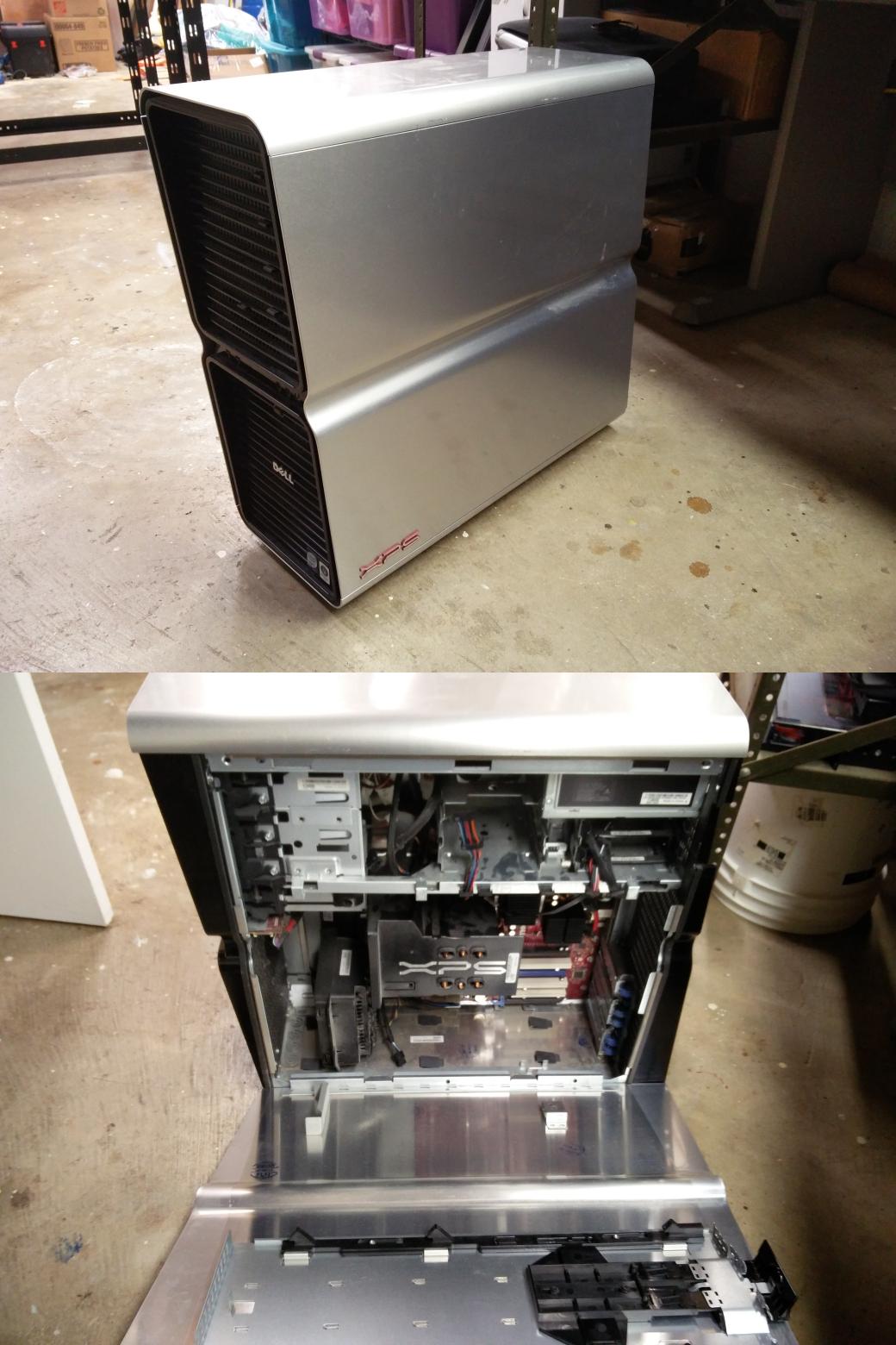

I have an old Dell XPS case. You'd have to mod it, but it'll fit. It's basically the size of a small refrigerator.
