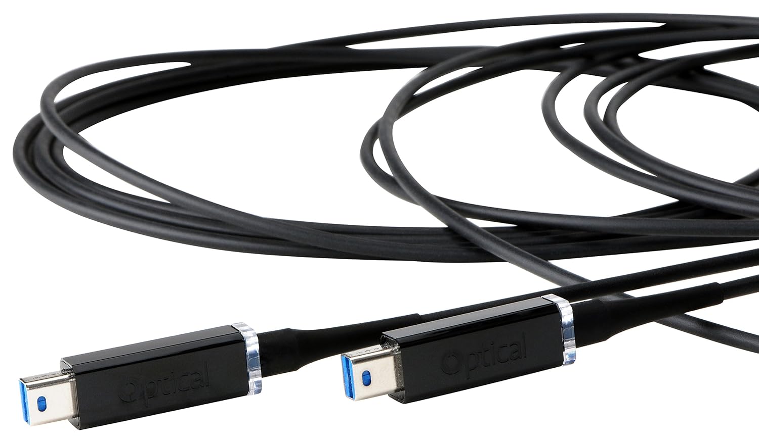

At that length you will need a repeater/booster they are not unreasonably priced 40 to 70 EUR. Or you drop 100-200 EUR for one of those optical 5m+ cables.

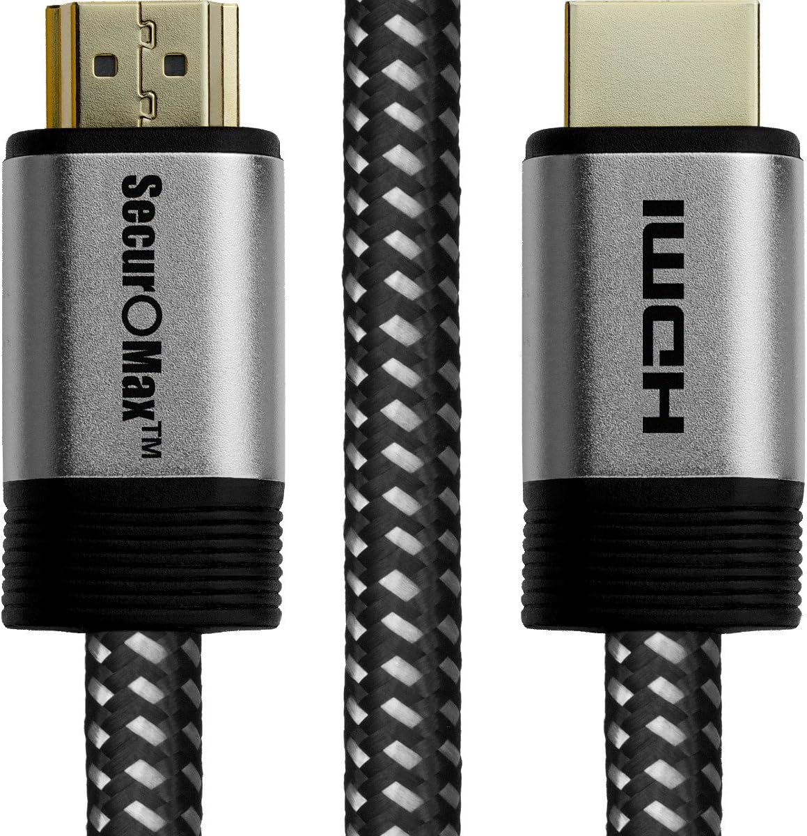

I think I need to try HDMI cables. Reading the reviews this one should work at 25 feet:
Because long DisplayPort cables do not support higher resolutions at 60Hz:
@alphazero1990 Heh.. $149 for a cable... nahh... :slight_smile:
Yep that's why the optical or the repeaters are the only option if your stuck with DP. I don't think those long cables can even support Full RGB or higher bit panels.

$40 for a 50 foot HDMI 2.0 w/ethernet cable seems pretty reasonable
You just need HDMI 2.0, like mentioned above. I had assumed that you knew that. It isn't hard to come by. Same thing for Displayport 1.2.
I can recommend that cable, I have it and does well.
