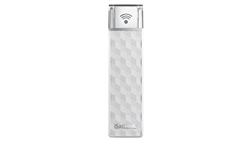

Alright so ur saying that even if I get a router I would not able to host a network just accessing data from my hardrive without going though the internet? Im just trying to do like the storage stick that host it own wifi so i can access the data without plug it into my computer
This is what I"m talking bout by the way

Basically i just want to do what the sandisk stick above do but at a greater scale. Sorry for being confusing
