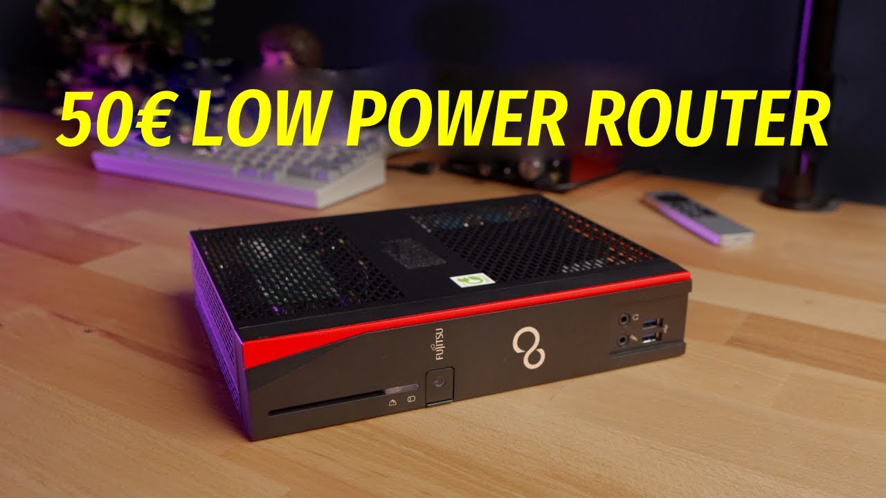

Hi there.
wasn’t here for quite some time. As the Fibre is now at least burried in the street and I really need to prepare the lines inside the House I thought about the Firewall/PFsense Idea again while I stumbled upon this Video:
So now I got one of these thinClients (Futro S920) and i am still looking for a NIC with two SFP(+) ports to get 1Gbit/s in and maybe even more to the server/nas I started this thread about.
The cheapest options for 2-Port SFP(+) NICs I can find in Central Europe are IBM Emulex “Virtual Fabric” Cards or FibreChannel… But I can’t find a clue if one of them might be usable for getting a >1Gbit WAN and LAN-Port for my pfsense installation…
also in-budget would be some Broadcom based NICs but there I’m not sure if they are compatible with pfsense, because I wasn’t able to find them (or Names that start with the same numbers as those on the NICs I found) on the FreeBSD Hardware-Notes they link to: FreeBSD 12.2-RELEASE Hardware Notes | The FreeBSD Project
