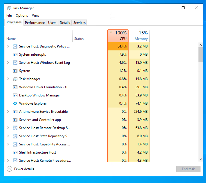

I’m seeing high temps on my unit…
I’m running Win 11, qBittorrent, and HA OS via Hyper-V at 1 Core, 2GB RAM assigned to it.
previously i was running at 4 Cores, 4GB RAM, and it was hitting up to 90 degrees which caused throttling.
I do not remember if I have replaced the thermal paste when I disassembled my unit.
