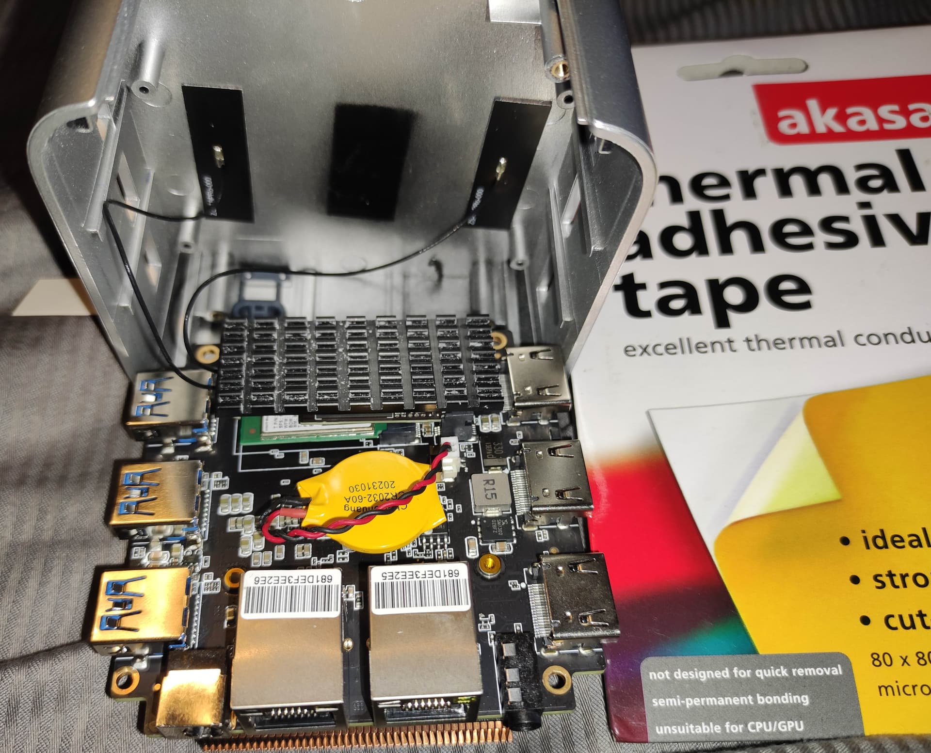

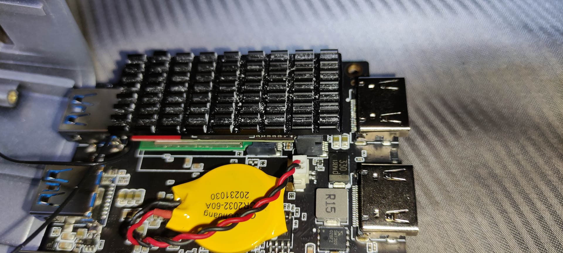

Did anyone try replacing thermal paste and noticed any difference? I see on reddit a few people did it, and supposedly it has some positive benefits. From IreuN photo in this thread, seems like the factory did a poor job applying it.
I considered replacing the paste but didnt bother in the end its only a low power cpu

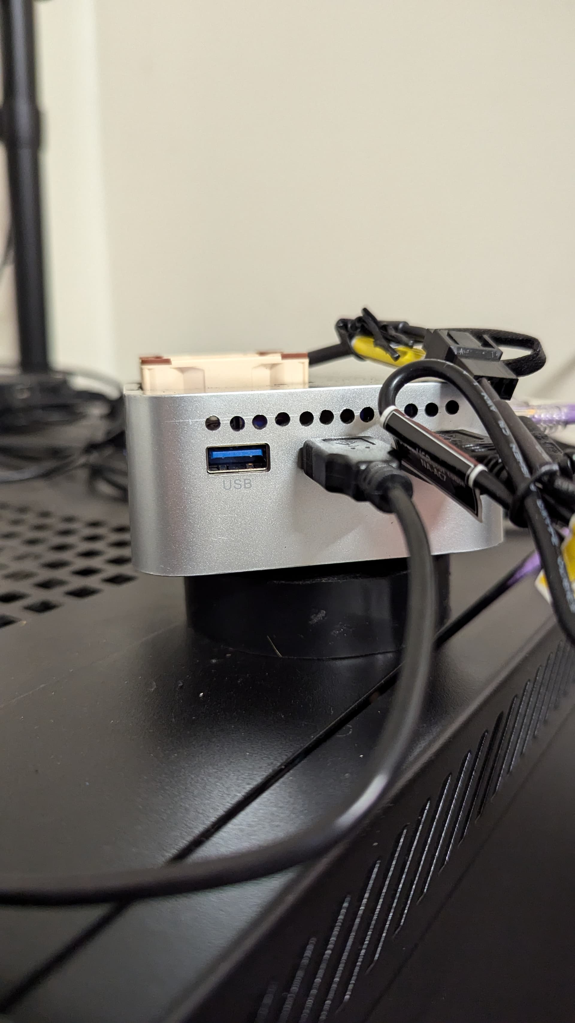

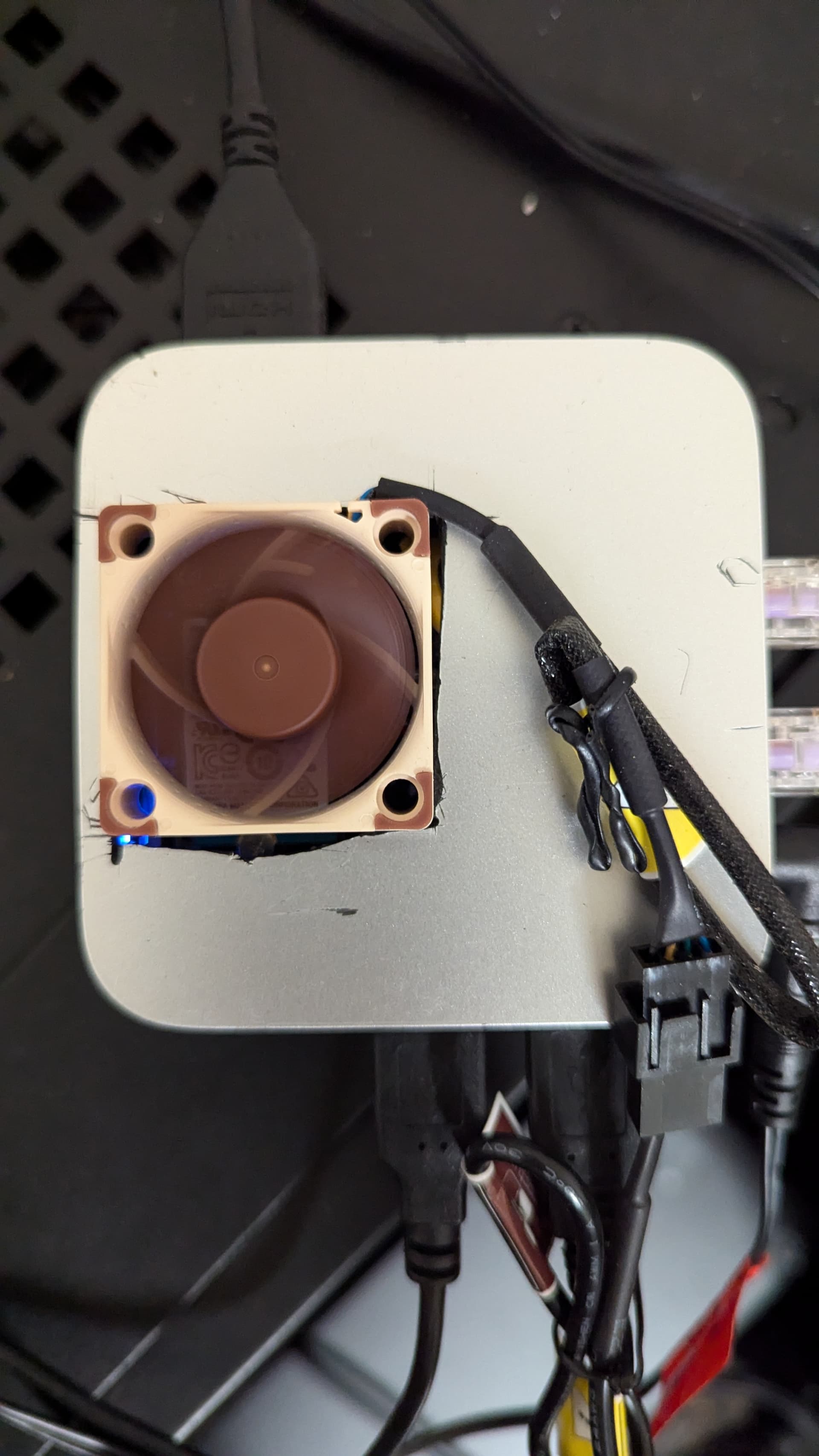

I too noticed the (NVMe) drive was getting toasty, no surprise seeing as there isn’t really any airflow in the top of the Firebat T8 Plus. Soooo, I chopped a hole in the top, stuck a Noctua 5v USB fan (NF-A4X10-5V-PWM) in there, and drilled several 3.5mm holes in the case along the top of the USB and HDMI ports. Bonus, now I don’t have to strip the Mini-PC down every time I want to remove the drive lol.
Here’s some pics for those that are interested. Not the most elegant solution, I definitely could’ve taken my time a bit more lol but it’s out of sight and does it’s job so I’m not fussed.
