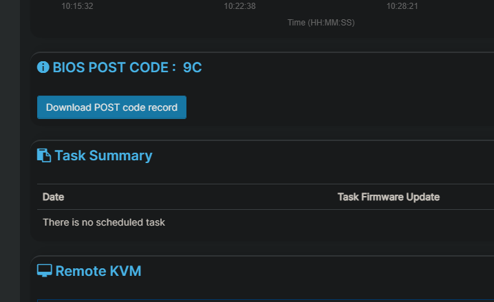

Post code should be on the dashboard (homepage) of BMC.

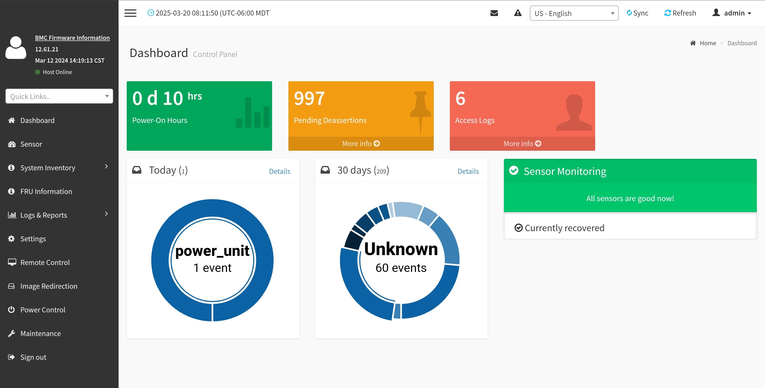

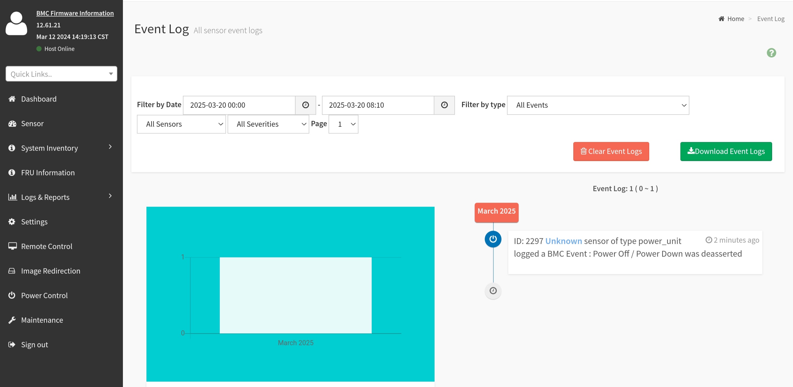

A POST code record would be perfect!
Unfortunately I can’t seem to find this in my BMC web UI, and nothing useful under logs either… Huh.
I guess mine was a newer version BMC.
