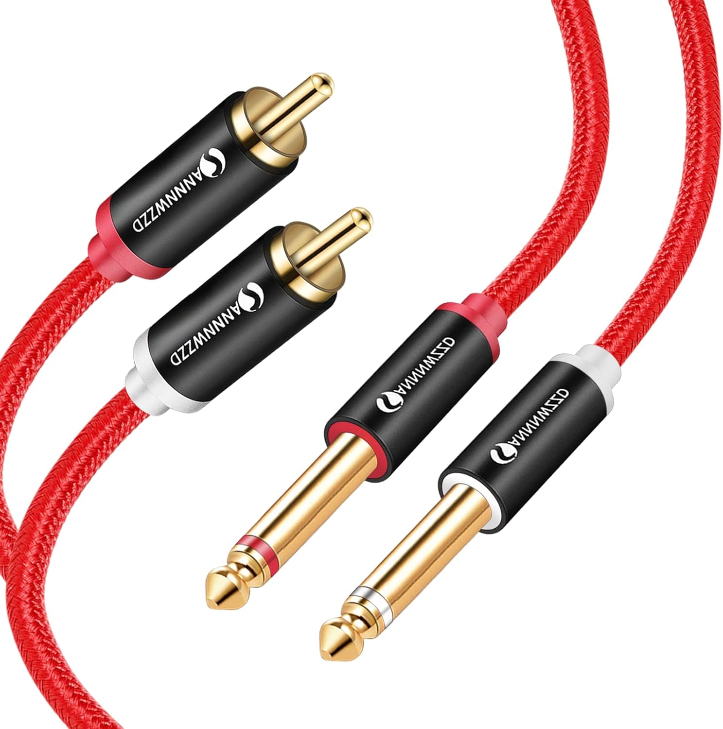

Hey @MadMatt I’m having a couple issues with the L-12, the primary one being that when I connect the outputs on the Schiit Modi DAC (2x RCA → a TRS cable), into Mic line/1, I enable the HI-Z button.
I’ve tried having the compressor set to medium, with least gain, but I find the audio either on (A) headphones (Grado RS1e, can be driven direct), vocals are very much blurred out and feel terribly dampened, and even slightly echoey.
I’ve got the EQ to (off), EFX return on mute, Rec/Play (off - don’t care about SD). On the back, the sample rate is 48Khz (I might fiddle with this).
Any ideas?
Driving a signal from (B) → Schiit Magni 2s, are as bad as the direct (A) through the same headphones.
If I remove the L-12, the audio is great again.
This works - PC → L-12 interface over USB, the audio is great.
However, SPDIF → Schiit modi (pre-amp outputs) → (2x RCA → TRS) → Mic/line 1 is not great at all. ideas?
One clue is that the L-12 input are 68ohm input impedance, whereas the Schiit outputs are 75 ohm. Hmm.

So the issue is with the TRS → 2x RCA TISINO 1/4 to RCA Cable, Quarter inch TRS to RCA Audio Cable 6.35mm Stereo Jack to Dual RCA Insert Cable Y Splitter Cable - 3.3 feet/1 Meter
Another update
The issue is with the XLR/TRS jacks on my L-12. When the TRS jack clicks down, it is not making full contact with the TRS jack, and the audio is not 100%. I can barely wiggle the connector and get the full signal. I’m going to send this back for a replacement

Ok I think the issue here is I’m being a bigger idiot and forgot the meaning of Balanced in the context of TRS.
So when I use a TRS RCA cable. It is expecting the same mono line to be connected to both the R/L of the RCA jacks (?)
If I supply a stereo signal on the TRS cable, the R/L will try to cancel each other out.
So when I used RCA > RCA the each channel was preserved. Thoughts?
Sorry, I completely missed your RCA to trs only had one TRS … use a dual trs one and use two of the l-12 inputs:

Thanks @MazeFrame & @MadMatt - BTW the cable I mentioned (Cable Matters Dual RCA to XLR Unbalanced Interconnect) - works great.
Noticed the line-level input had a bit of crackle on line1/2 with Hi-Z off; preferred the quality with Hi-Z on. Moving to 3/4 (through to 8), the best signal is with PAD on (the sig led goes green). Without the attenuation, it’s red and seems to clip.
Now, with regards to what really threw me off at the start, is this cable.
This works fine on the “monitor out” section of the L-12, where it’s TRS (wired as a Stereo output). However, trying to use this for a line-input will lead to the silly assumptions I made.
