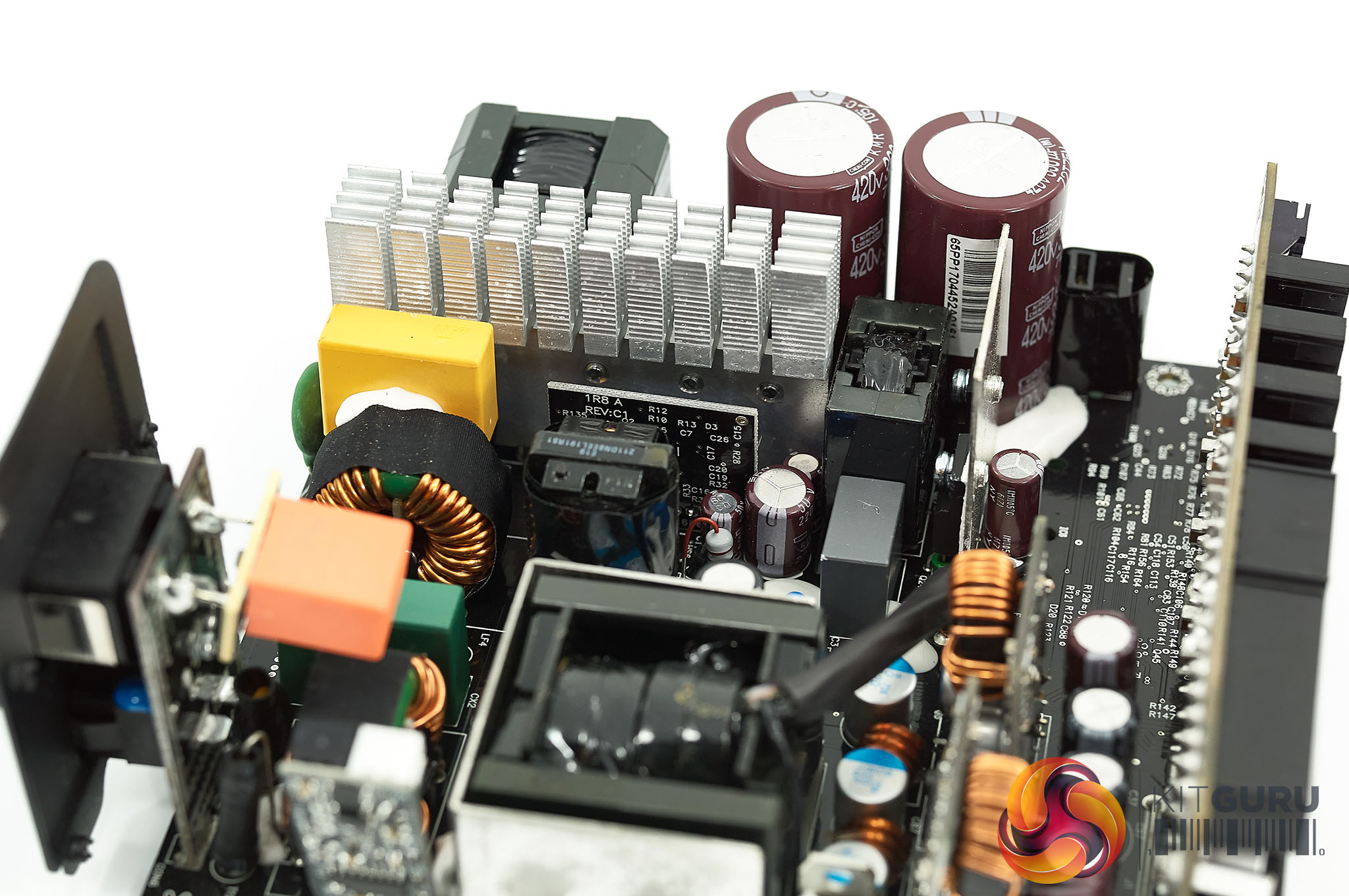

Aerocool gave me vietnam flashbacks to exploding PCs and dumbsterfires, however, that exact PSU recieved a very good review from Kitguru. I am a bit shocked to be honest.
Alternatively, the SeaSonic Focus Plus 650W will do a fine job too.
