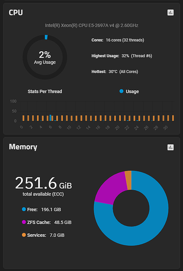

That being said - I do have 256GB of memory in the NAS so there’s plenty of room for ZFS Cache.

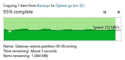

Optane doesn’t brrr as fast the network (P1600X 58GB). So testing with the WD SN750 1TB boot drive.
Network will saturate write buffer of my Patriot Viper VPN100 SSD (at 65% filled) if the file is in the ZFS Cache.

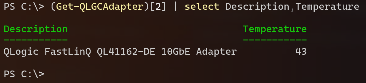

There’s probably a toolkit that can read the card’s temperature. For example, the Fastlinq interfaces have this:
