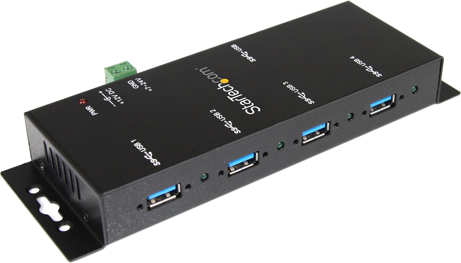

I am expanding the rear, switched USB3 port with this Startech hub. It’s been setup that way for a while though and no issues until now.
I’d power cycle the hub and maybe kvm. It’s probably ok. Things get wonky with USB in general when you have powered hubs or devices. Lmk if it keeps up.
