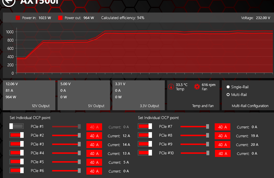

Multi rail vs single rail doesn't tend to really matter, single rail is just a bit more unsafe when it comes to shorts.
All multi rail really means is that the connectors are grouped with shunts that sense the current going to groups or even individual connectors, so if say 1 of the 8 pin connectors are drawing 50amps alone that obviously means something is wrong and the PSU shuts down.
A single rail PSU with 100a on the +12 rail can deliver those 50a to the short without knowing where the current goes, and thus can damage components.
Usually multi-rail and single rail PSUs all have a single +12 "rail" that, but multi-rail splits it into multiple ones so no single cable or portion gets overloaded.
Here is an example of a PSU that is both multi rail capable and single rail capable through software, notice how the connectors OCP are set to trigger at 40a.
