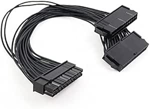

This is the solution. Can also buy power cords that have 2 female plugs wired to a single male so you don’t need 2 cables/ This is common with enterprise hardware. As long as each PSU can hold up it’s end, you should be good. Might need to jump the 12v mobo connector to supply power on other leads, but definitely doable.
something like this is what it sounds like your after.
turns on the slave power supply when the master power supply is turned on
