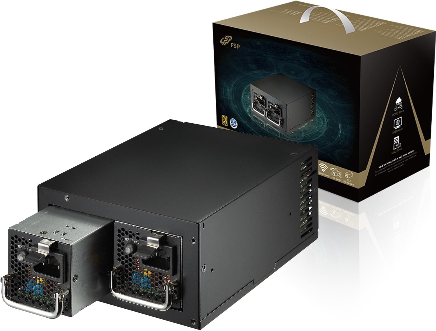

They have dual single ATX psus
Like these
