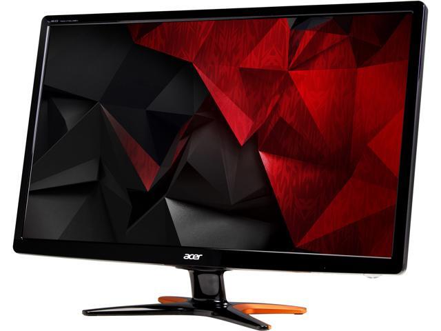

The PC Part Picker link is all high end gaming monitors, however I have to retract my statement about IPS. I honestly thought we were there now in 2016 where 144Hz IPS non-gsync were affordable, but I was wrong.
Here is what I was thinking of, but these are TN panels. Still good monitors though.
http://www.newegg.com/Product/Product.aspx?Item=N82E16824009642
http://www.newegg.com/Product/Product.aspx?Item=N82E16824236313
