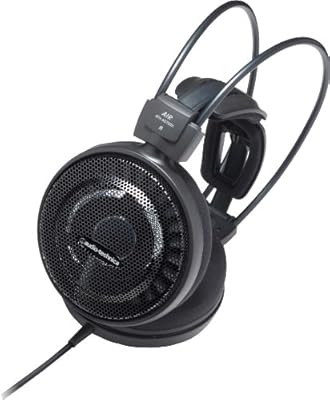

AD700X? I've never actually tried that model. I would definitely say that's the entry-level price bracket if you're wanting good headphones. I'm an audiophile though so I should prolly just shut up.
I took it in jest.
Those are the headphones that I have been using for the past year or so. I get good spacial awareness in FPS games and they sound very clean without any silly frills. I would recommend them to anyone looking for the most bang-for-the-buck for gaming. I'm not an audiophile, but music/movies sounds great too.
