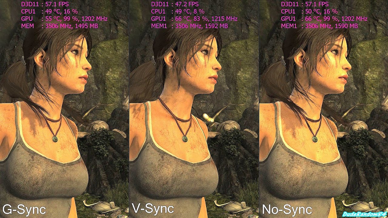

Related: ULMB and G-SYNC are exclusive and cannot be used at the same time... does G-SYNC do anything for motion blur? Pretty sure it doesn't. Read something like "ULMB is for high frame rates and G-SYNC is for frame rates below 60." Accurate? :P
Thanks for reading.
So G-Sync syncs your refresh rate to your framerate. So that means if your fps < monitor refresh rate, you get another feeling animations. When they're not in sync, it is forced to hold onto some frames until the next refresh tick which ultimately causes some of your few very valuable to additionally be dropped. (Over-simplification but that's the gist of it.) All that said, G-Sync is an expensive feature currently. So that alone is going to be hard to get and will eliminate a ton of options. Losing this feature might be the equivalent of 48fps appearing more like 44fps (if somebody corrects my numbers, I admit that I could be a little off buy i think I'm close). You decide if that's worth a lot of money to you.

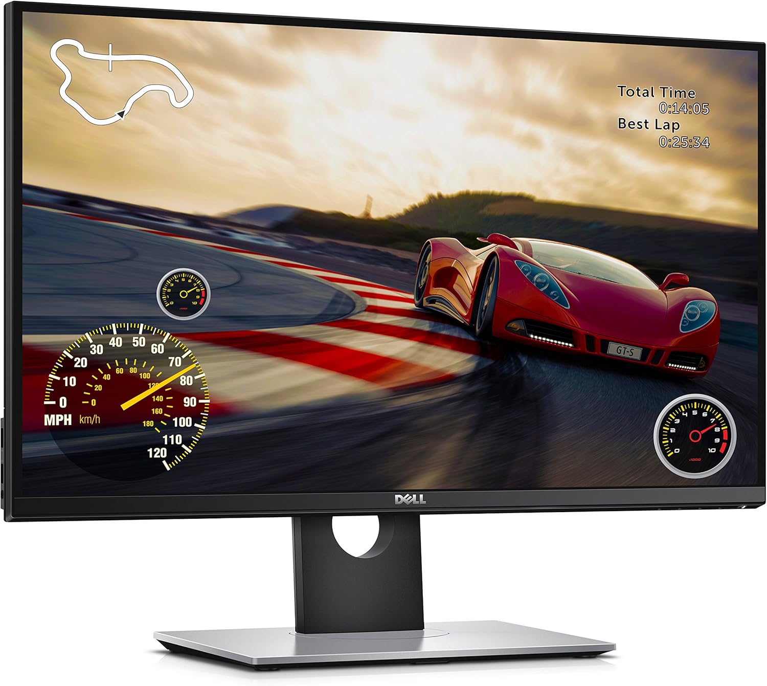

The cheapest 1440p G-Sync display is currently this one:
3440x1440p can be had at $500, but reliable brand 3440x1440p starts at $635. But, your talking standard non-sync panels at 60hz. G-sync 3440x1440p starts at $1200, and is limited to 100hz until the newer display port standard is implemented to allow for 144hz and higher.

There's a 1440p Gsync monitor on sale for $480 atm
