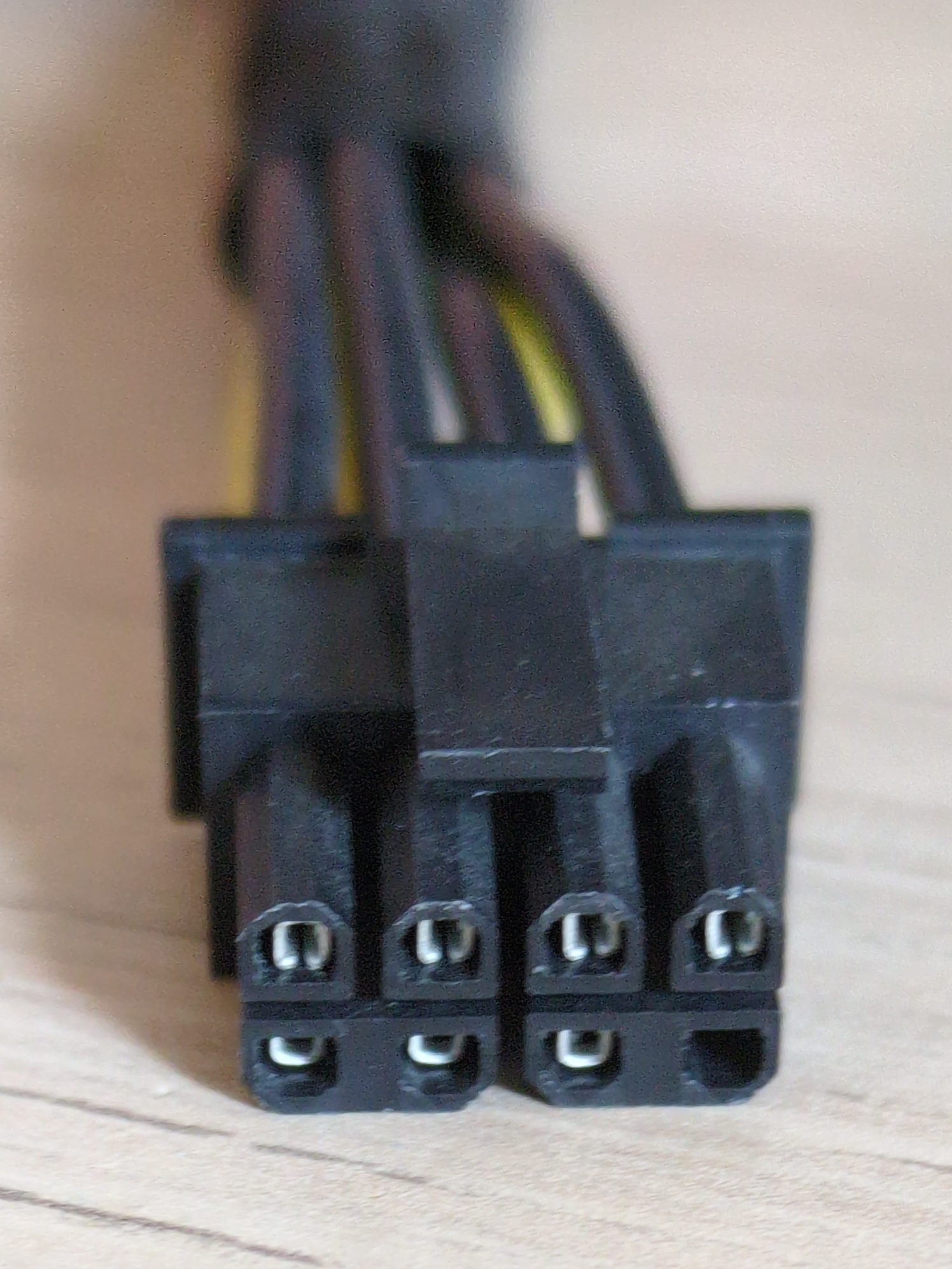

I’m trying to make a PSU cable that will allow the installation of consumer grade GPUs on my Dell server.
The reason for this is that Dell cables ( at least the 04VPD3) are made for enterprise grade GPUs like the Tesla V100. The one that I bought is short and it cost me 15€.
Coming back to topic, I would like to make my custom cable but I can’t seem to find the part number of the connector, on the motherboard side.
Does anyone knows what kind of connector this is and where I can buy it? Or is it a proprietary connector from Dell?
I attached a photo of the connector.
I couldn’t find out either, seems proprietary.
But why not use TR5TP? From the pictures I found it looks like a regular 8+6 PCIe cable
This looks like it could be a Micro-Hi connector by BellWether.
https://www.digikey.com/en/products/detail/bellwether/70093-0800/22205630
I noticed this kind of connector also on other server motherboards from other manufactors.
I think this is some connector for hi-power coming from the Open Compute Project specification.

Thanks for the precious tip on the connector, @gysi !
I will order some and test.
