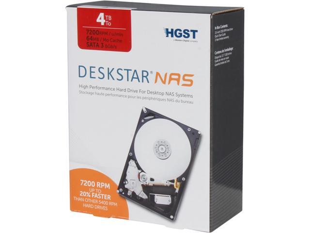

As far as the new drive goes - that I wouldnt buy for a few reasons
6TB is asking for a drive failure
5400rpm is slow as balls
have a look at this - HGST is rock solid.
http://www.newegg.com/Product/Product.aspx?Item=N82E16822145912&cm_re=hgst-_-22-145-912-_-Product
I've had the BIOS set to AHCI since day one, I believe.
Repinning hasn't made it go away. I'll keep playing with it till I find a way to get rid of it. Strange thing is... I went into the registry. It's not even there. Like... all my other pinned programs are there. The bugged one? Gone.
6TB might have double the failure rate of the 4TBs, but that's not saying much at only 7ish%. I suppose if I had 2 4TBs from WD that'd be a safer way to go altogether. It seems like the 3TBs are what you want to stay away from. 40% failure rate from Seagate in 2014??? WTF are those guys doing??
5400 is fine, regardless of being slow. Backup/duplicate drives don't need to load fast.
Also, those 4TBs are more expensive per TB than that 6TB, which is why I ask in the first place. In total, I have: one SSD (which won't be backed up, all I have on it is easily replaceable utility programs), one 3TB, one 250GB, one 150GB, and that 750GB WD Black that's refusing to work right. That drive is going to be replaced by either the 1TB my friend salvages (if he can) or one I might get from my father. So 4TB isn't quite enough to back up everything in the way that I want to do it.
Honestly, what I need is a NAS so I can one-and-done this BS. But I can't afford that. But a single 6TB at $215 that's just big enough to cover me getting another 1TB and/or replacing those small, old drives I use for music/documents/etc? The reason it's appealing is it covers what I need at a price I can afford right now. And at that point, gambling between a 3% failure rate and a 7% failure rate doesn't bother me that much.
