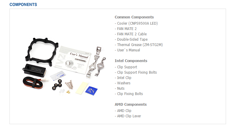

I just want to make sure that I am not seeing funny. The Intel clip did not seem to come with my CNPS9500A LED fan. Does any of the parts look like it to you?
One of the clips looks like it's already on the bracket, otherwise they might just be the same thing
The clip on the right is not listed in the manual, the clip in the center does not have the Intel Clip Lever attached.

I don't recall a clip lever being needed when I installed that cooler on my 4690k last year(but it has been a year so my memory might be fuzzy). I think I ended up using the clip on the right in your top picture screwed into the clip support.
All that being said I'd highly recommend a different cooler if returning it is an option; mine is loud when the fan ramps up and struggles to keep my overclocked 4690k under 85c if I'm working it hard(as in encoding video or stress testing). I'm pretty sure I could get a higher overclock on a better cooler. I'm planning to rebuild my system in a better case and switch to a better cooler in the future.
Edit:
Looks like you might have everything judging by the pic from Zalman's site:

I ended up successfully installing it. I had success with Zalman and an earlier AMD build which is why I went with them again. I would rather avoid the hassle of dealing with returns.
Evidently, though the components listed on the manufacture's website are correct, the components listed in the physical and online manual are wrong and so are the instructions.
