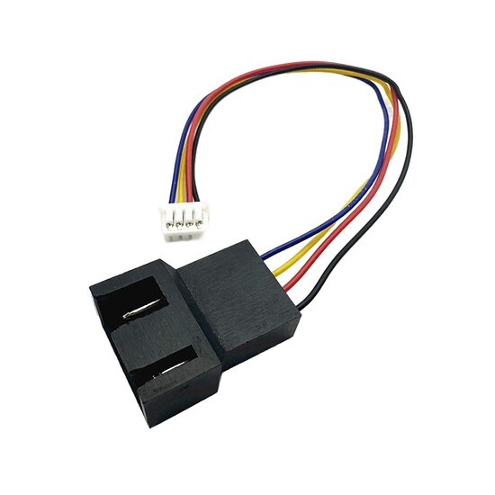

I tried to plug in a 4-pin ZH1.5 connector but couldn’t get it in, it seemed to be just slightly too large. My light wasn’t good so I’ll try again later on a proper work bench but if someone has successfully connected a fan there I’d appreciate confirmation that it is indeed a ZH1.5 connector or what the connector type it is if that’s not it. The connector is also marked “NVMEFAN2” so I assume it’s controlled the same way the other NVME fan is.

I just measured the pin-to-pin pitch of the NVMe fan connector with a caliper, it is 1.25 mm. The pins also appear to be flat/rectangular in cross-section, not square at all. So I believe this is most likely a Molex Picoblade 1.25 mm pitch connector (Molex 510210400 is the “receptacle housing” part that goes on the fan cable). This type of connector appears to be erroneously referred to as “JST 1.25” online, even though the only connector JST makes in 1.25 pitch is the JST GH series, and that has a locking lever, and our mystery one doesn’t. I bought some 5V 4-pin PWM fans and varied “JST 1.25” pre-soldered cables on aliexpress, will report back if I manage to use any of them successfully without excessive soldering/filing/gluing. The alternative is of course to buy the actual Molex part from a component supplier (don’t forget the metal part of it too, or a pre-crimped cable with it!) if you have enough in your order to justify the additional charges for reel cutting, shipping, etc.

Please do report back on the suitability of the Aliexpress “JST 1.25” connectors, that just might be the right (though incorrect!) answer!

Yes, just got a few parts including the original Molex ones, and the “JST 1.25” random Aliexpress extension cables worked perfectly (funnily, LCSC has an interesting name variant “MX 1.25” for the originals, I guess that keyword will work too. You can also find some “Picoblade” exension cables on Aliexpress). I then got a Intel NUC7i5DNH compatible 5V 4-pin PWM fan (also marked as Gigabyte BRIX compatible, etc., I believe these mini PCs all follow the older Intel NUC designs), then manually matched the wire colors to NVMEFAN1 colors of MS-01 by rearranging the wires on the extension cable, and it works perfectly (the NUC fan pinout is visibly different from the Minisforum ones, but the individual cable colors are correct (like, black is ground, …) only their order in the connector is different). Fan speed is controllable in the BIOS, the motherboard reads the speed back correctly, etc.
Awesome! Thanks for the confirmation!

I can confirm the connector for the second m.2 fan header. I just bougth this from modify, that breaks into a regular pwm fan header. Going to test later today with a Noctua fan.
