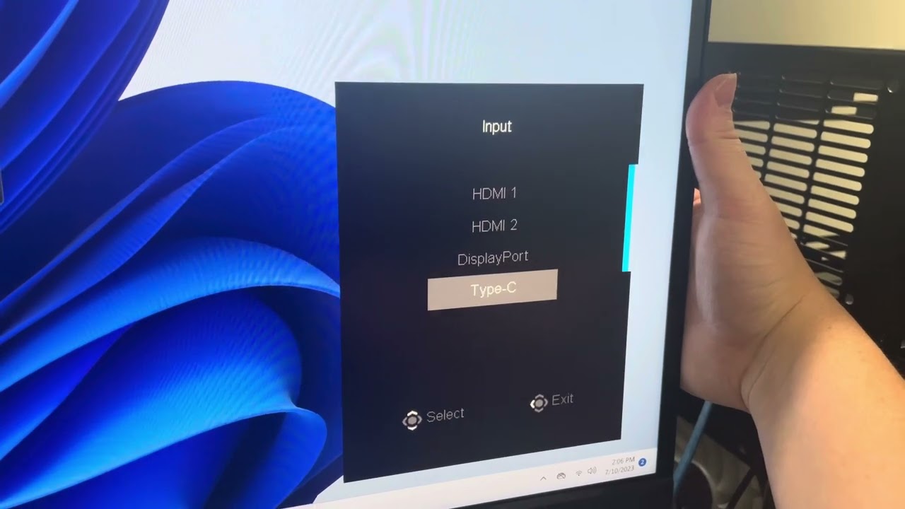

First of all, I’m really sorry for the audio in the video being super rough. My phone is on its last legs LOL
The video is just showing I was able to get display and data working with the dock.
It’s important to realize this dock, and docks in general really can be fickle and your mileage may vary. I had trouble getting the power delivery working along with the USB-C output to the monitor. Other than that, working well. I was able to fix that by just plugging in the mini PC’s power brick
