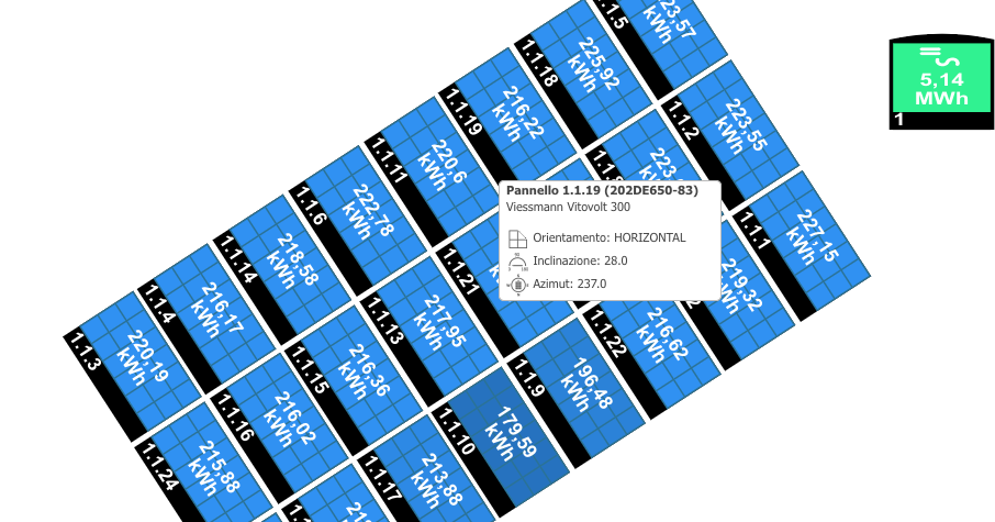

I started monitoring my home energy consumption more than 15 years ago using arduinos and TA sensors, data delivered to a raspberry PI over RF 868Mhz, then, after collecting data for a ouple of years, decided to add an initial home automation node, using arduinos, then added 6Kw of solare panels in 2016 when installing heat pumps. Our yeat PV production was slightly over our consumption (7MW over 6MV)
I then changed the TA meters to Modbus ones, started working from home, then we bought a PHEV car in 2019 and our home consumption shot to 10kWh/year
Last year I added a 10kWh Battery and this spring another 6kWh of photovoltaic production capability …
I recovered the first solar install in 4 years, and with current energy prices in Italy I expect to recover the battery in 7 years and the new panels in another 5. The money I am saving from the initial solar array install more than cover the cost of the new ones …
I was able to optimize my spend and customize my desgin and deployment because of the consumption data I collected during the years
For kicks in 2017 I did an analisys of whether it was worth installing a tesla battery, and it turned out at that time and with 2017 energy prices it was not worth it …
