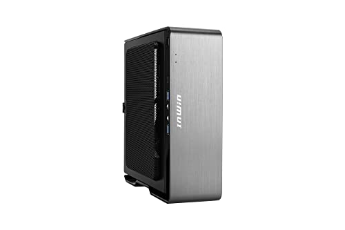

If you want off the shelf, readily available, have a look at the slightly large, but suitable InWin Chopin:

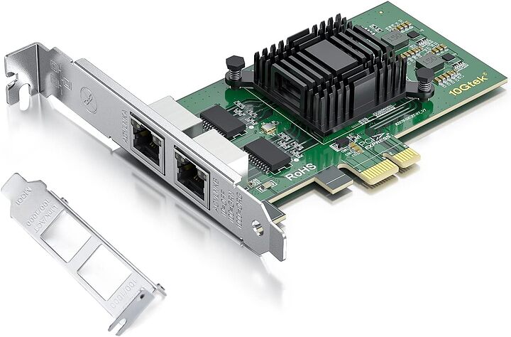

And of course, a GB NIC:

  • Realtek NICs are not recommened for network equipment and one slot really limits and also only Gbit instead of 2.5Gbit which TS asked for. Getting a 2.5Gbit (or faster) dual or quad port NIC from a somewhat reliable vendor is quite expensive

  • Linked Intel NIC uses ancient controller, not 2.5Gbe (again), likely recycled parts and/or fake ones
