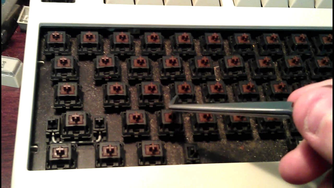

Had no clue that was a thing lol. Just looked up a quick guide for it too:

For linear switches yes, the only difference is stiffness, the colours are just to differentiate.
With tactiles the is a littler bit of slider shape difference, browns have a small tactile bump, clears and light greys have a large tactile bump on their sliders after that it is springs that also make the difference in those.
Clicky are almost all the same, at least from cherry, barring the white switch which is factory lubed to make the click a lot quieter. Other makers clicky switch mechanisms can vary a lot with the likes of Aristotles and Khail BOX click switches.

Yeah they are gonna need to be removed, desoldered, to lube them properly.
I have heard of people doing it in place. Taking the caps off, pressing the switch stem down, bit of lube on a toothpick tip and poked into the slider tracks on the left and right side of the switch. Then press the switches a few to many times to spread the lube around the switch and on to the slider too.
Need to be careful though and use small amounts of lube, donā€™t want it to spread to the contact mechanism and destroy the switch, then you will absolutely have to take them out.
