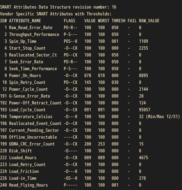

I’ve this drive I pulled out of my server a few months ago because I was getting constant file system errors. Smart stats would report multiple “uncorrectable” sectors. Last time I checked (a couple months ago) said sectors were around 5000. Weirdly enough the drive still works, I’ve an operating system installed to it and it seemingly works without issues. I haven’t tried any destructive methods of rewriting the sectors though. I wonder if that’s what it needs in order for it to be safely usable again (and ideally put it back into service since storage isn’t cheap).
My solution has been to let badblocks rip through drives showing errors. Usually by the third pass, the drive has reallocated the faulty sectors and a long smart self test will also pass. Going sector by sector might be a little faster though, it can take over a week to run three full passes of writes and reads across large SATA disks.
@Dank_Vader It’s worth trying, but 5000 is an awful lot of bad sectors. Usually there’s just a couple, when this kind of repair works.
The results are certainly conflicting with what I found on hddsentinel a few months ago. The drive looks healthy(-ish) according to its self-tests. I’ve fired up a long smartctl test so I’ll see how that turns out in a couple hours.
Very interesting as I got a lot of 2TB/4TB drives in my lab that were pulled out of servers due to SMART or ZFS errors that might be good to reuse in the future as prices of them are getting ridiculous lately
I don’t want to be needlessly optimistic but it does line up with Wendell’s example.
and current-pending-sector 197 suggests the drive really wants you to sequester it and fio overwrite the whole drive to bring it back then run a smart long test. in the case of a 22tb drive that’s about 3.5 days of continuous operation.
#194 – 51c is a bit toasty for a drive!
I dont see 5000 bad sectors in this output. It may be you’ve tried to read the same 12 bad sectors 5000 times which is less worrying.
Yeah it almost never reaches that temp. The highest I’ve seen it reach is 45. Maybe that 51 was while I had it in an external usb enclosure with no active airflow (I run it on an external usb enclosure ever since I pulled it out of the system it was running in).
But yeah, I don’t see anything resembling what hddsentinel was reporting; the drive looks like it’s in a better shape than I thought. I’m just scrambling for parts to build a testbed so I can plug the drive in via sata (I was told usb is a bad interface for such tasks) and run openseachest on it.

Any reason to switch from badblocks to fio?
My workflow:
  1. Document the drive based on ID: smartctl -a
  2. badblocks with 0x00
  3. badblocks with 0xFF
  4. Document the drive based on ID: smartctl -a
  5. back to dm-integrity pool

Nobody here mentioned selective smart tests…
I wrote this script that runs smartctl until it fails, overwrites the reported LBA’s secotr with hdparm and then runs a selective test starting from 1000 LBA’s before that (to re-check that area) via smartctl -t select,<LBA>-max /dev/sdX, it does that in a loop until the whole disk is checked. This way it needs to just read the disk once while also fixing all read errors on it.
Oh btw when running it on live zfs pools a following scrub may then report checksum errors because of those overwritten sectors, just clear those.
I like badblocks historically but it was taking 2x as long as fio for some reason.
Try set -b 1048576 . The default block size is 1024, which is way too small with direct IO.

That’s very interesting; I have a few drives failing the SMART test.
I was actually planning to replace them, but if I can put that off—since the data on them is backed up anyway
Then let me just make sure I’ve understood this correctly.
Basically, when a SMART test reports a failure—specifically a read failure—the idea is to try reading from the disk, and if it fails, write to that specific LBA?
I’m trying this right now, but it seems like there’s always a new LBA failing the check.
So, in a situation like this, should I just overwrite the entire disk using fio with the command from the post?
