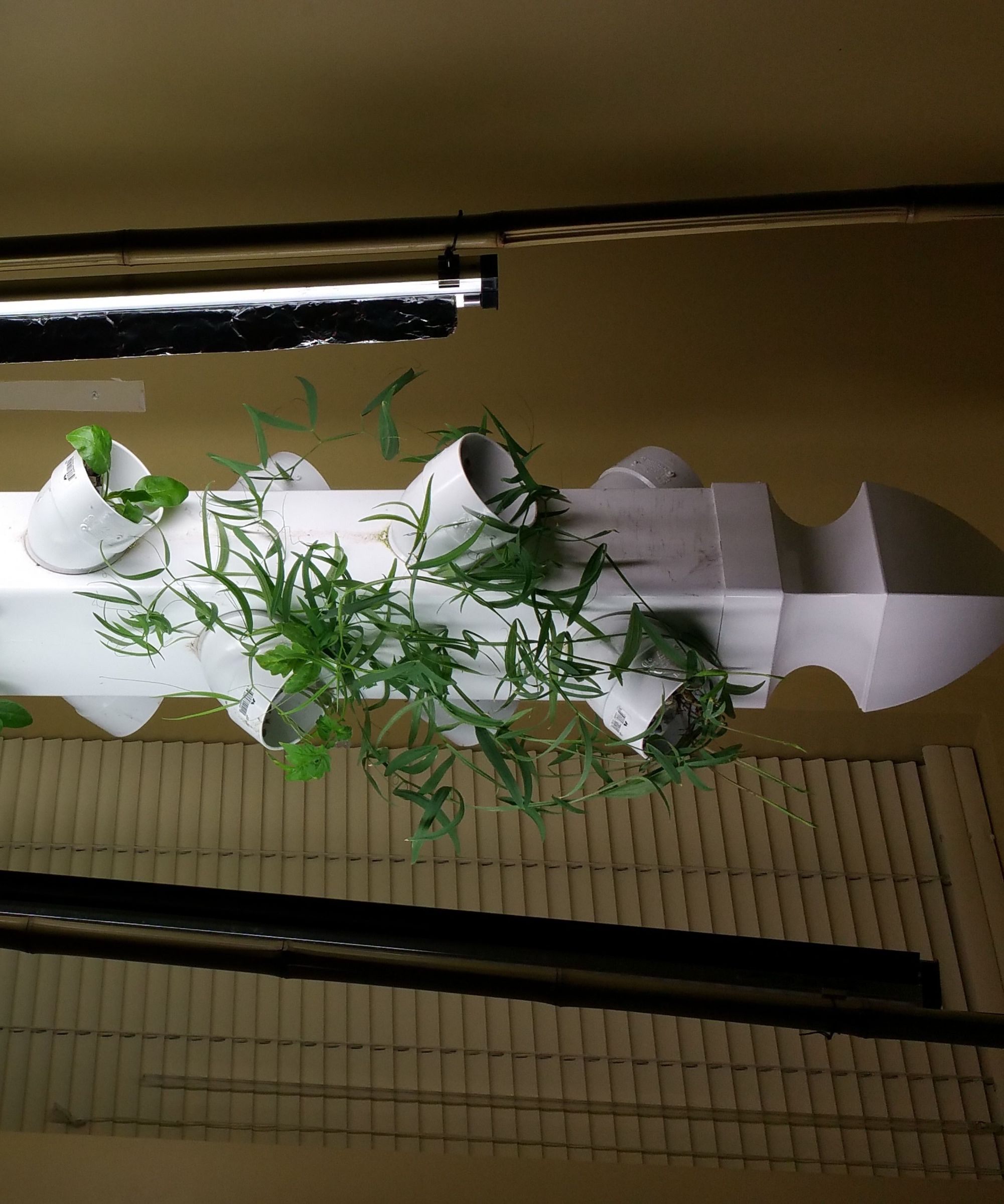

This looks like a cheap and easy system..You could also do it without the elbow joints if you cut a slit in the post and form it to your desired dimensions with a heat gun..Just beware that most/some plastics are toxic if they get to hot..
Just thought this was a nifty idea surprised it never came to me..
That does look pretty cool, i might have to add one at some point....
