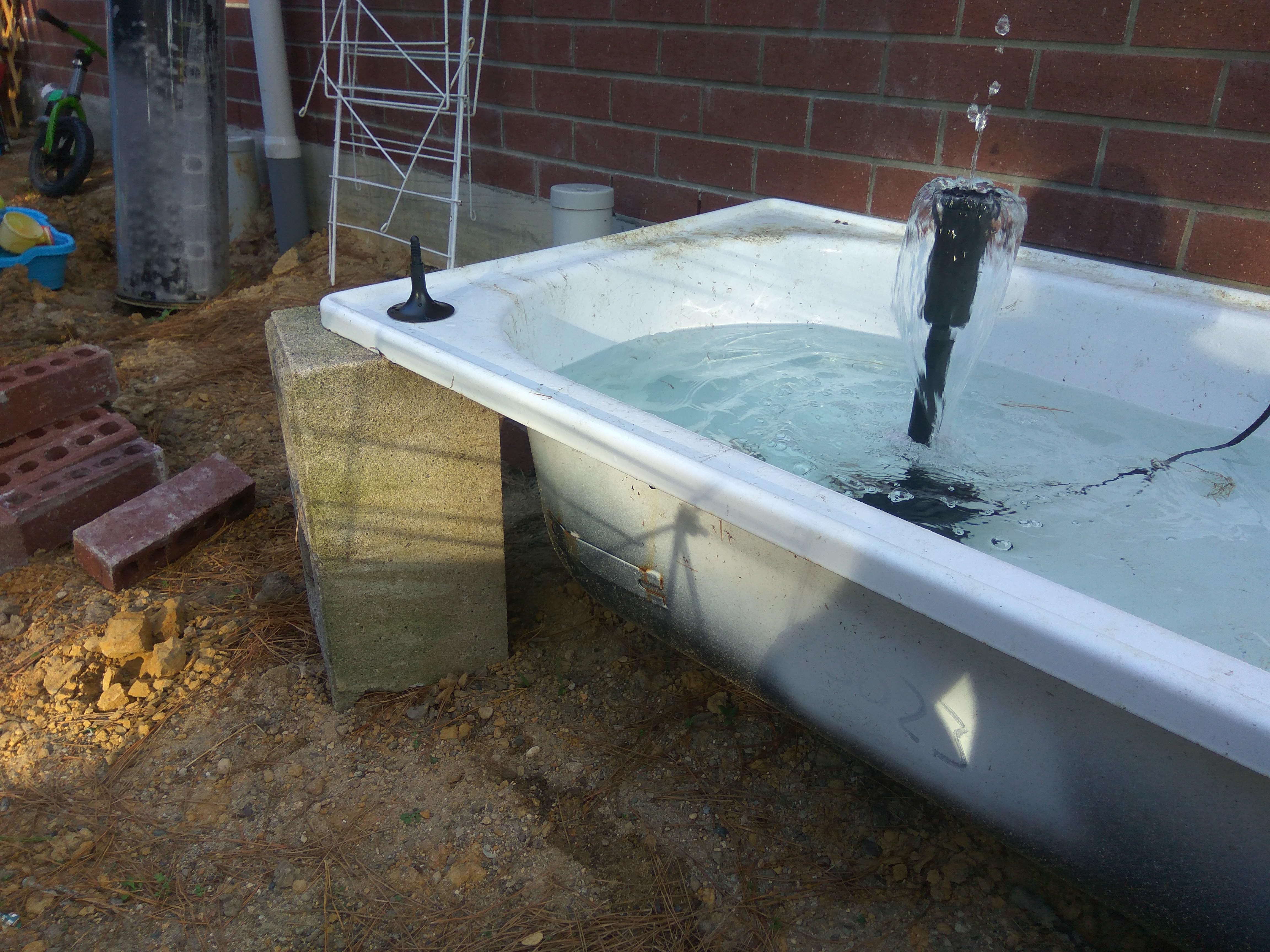

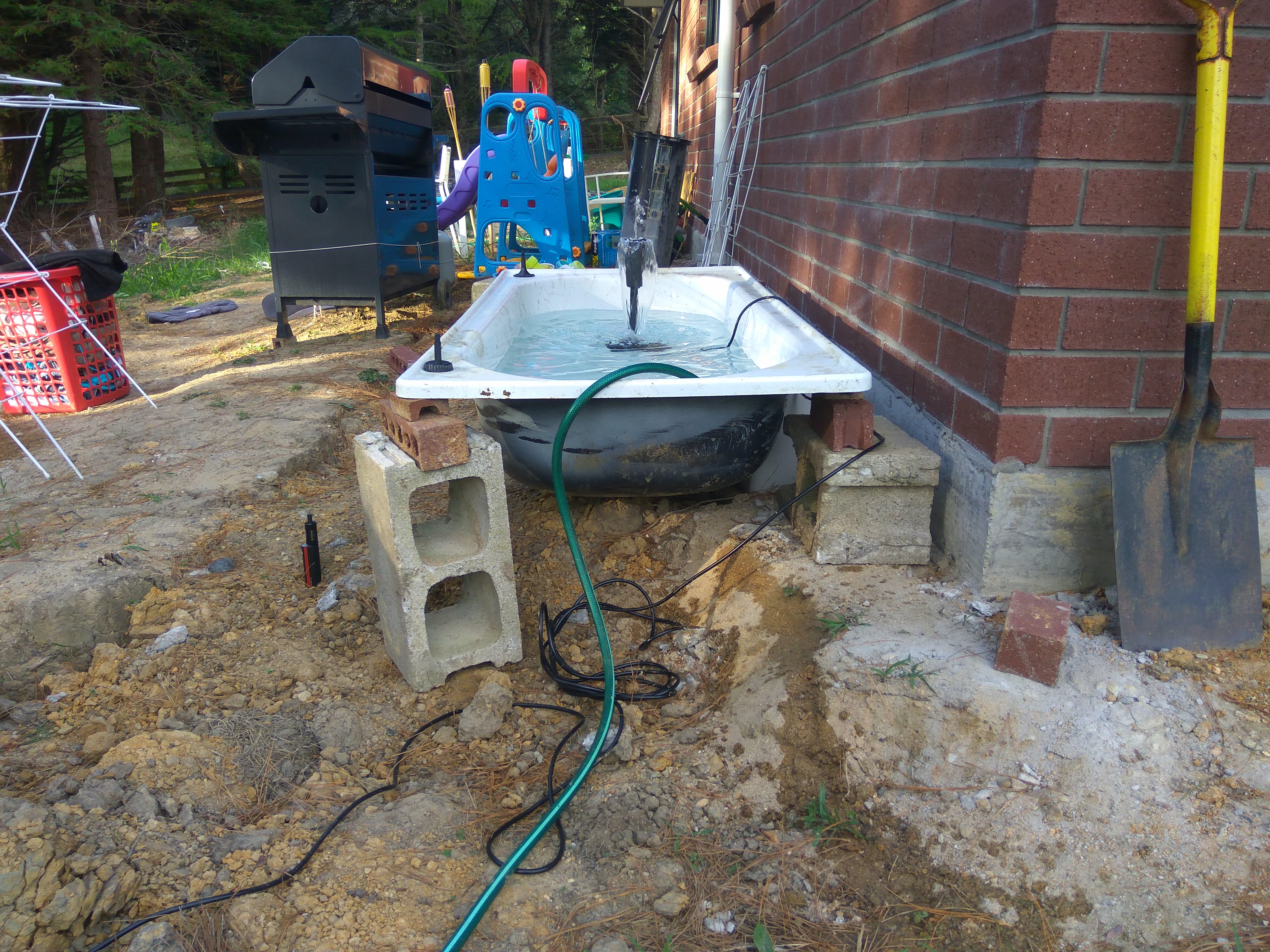

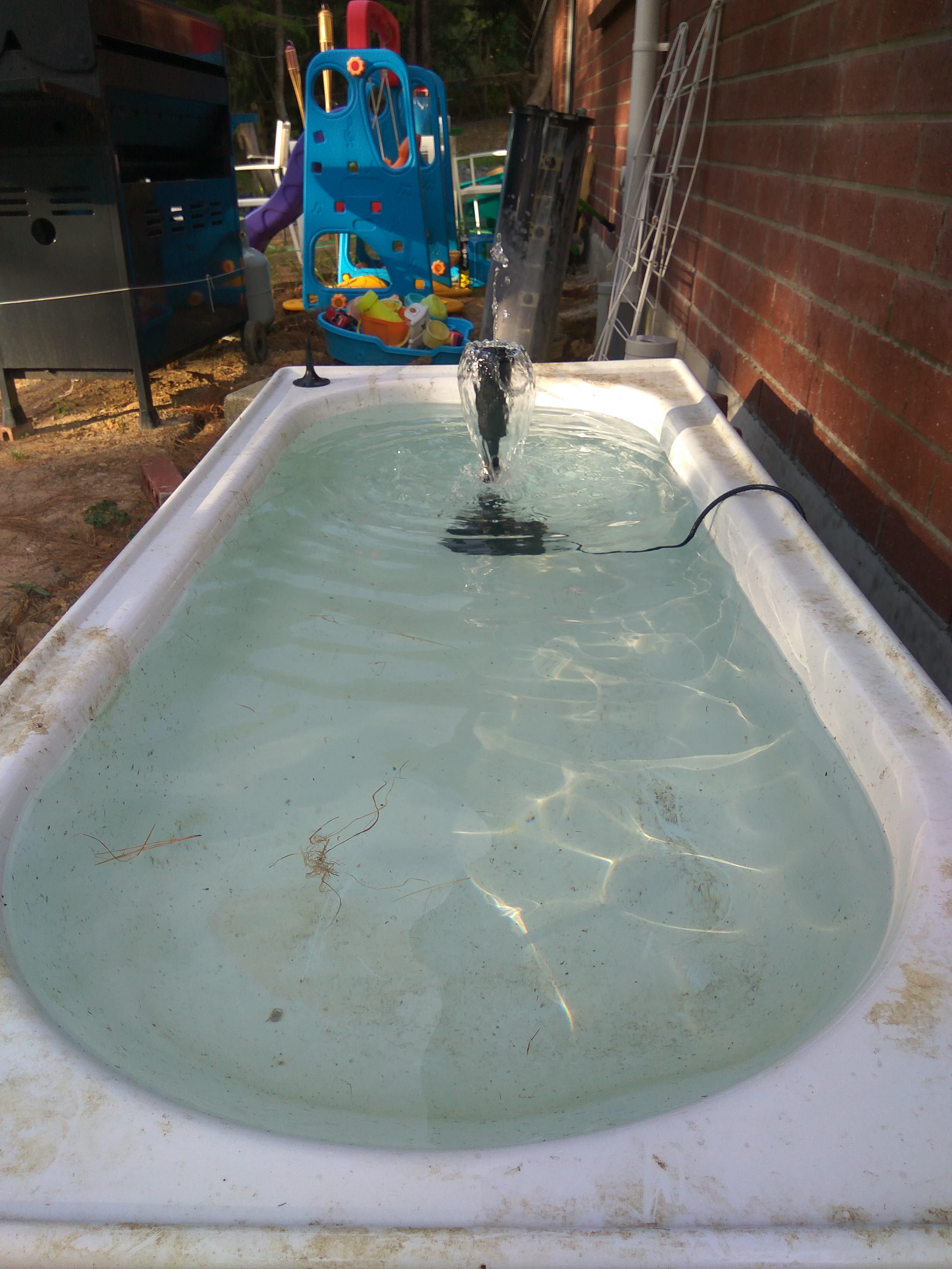

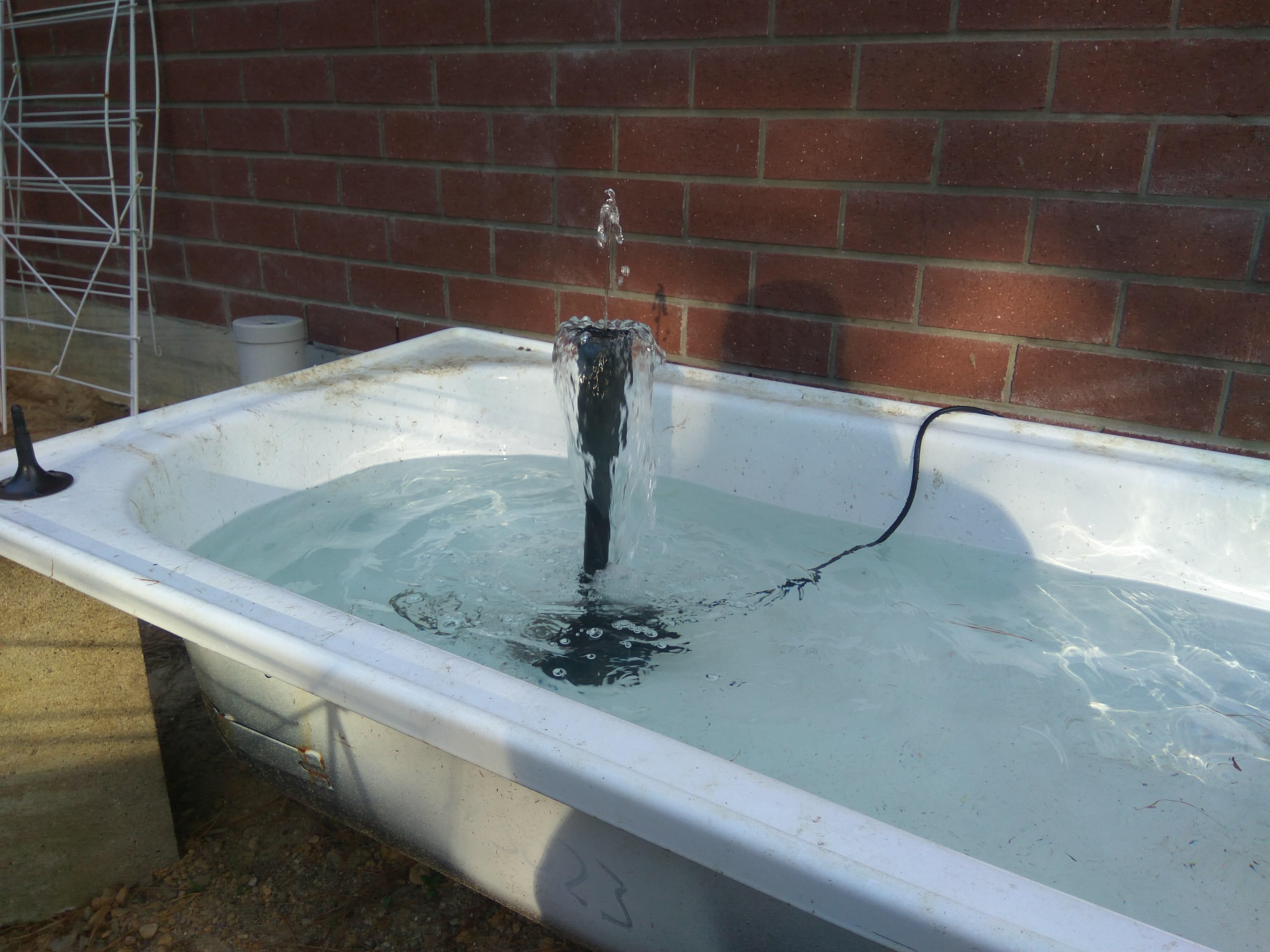

So since Picking this back up again over the weekend, I have got the Bathtub pond ( yes, this is the same tub from the last thread… i kept it all this time lol) in position, filled and a pump/fountain installed and running… Time for some pics i think…
So looking pretty ugly at the moment if im honest, but the pond is in a position that only gets full sun from midday through 4-5pm in summer ( good for the fish not cooking ) is reasonable close to the entrance of the house for easy access from the kitchen, and right in the area that after being filled ( up to level with the top of the houses concrete foundation) and paved to be used as an entertainment/BBQ area…
So highly practical placement for a supercharged Herb garden…
The pump is 1000lph ( 264gal ) and ideal for aerating the pond and driving a few small grow beds (and maybe a small - medium NFT setup for berries )given the fountain “stalk” also has a small T section with variable flow control designed to drive waterfall features etc… and only runs at 22w, so shouldn’t hammer the electric bill to much either…

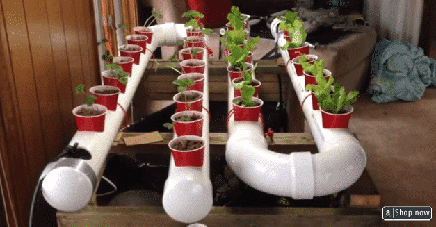

Similar to this, but multi-layered, and wrapped around the Back three edges of the Tub
Yep, that’s exactly what I was thinking. For the floating beds, I used packing foam from TV/Fridge/Washing Machine.
