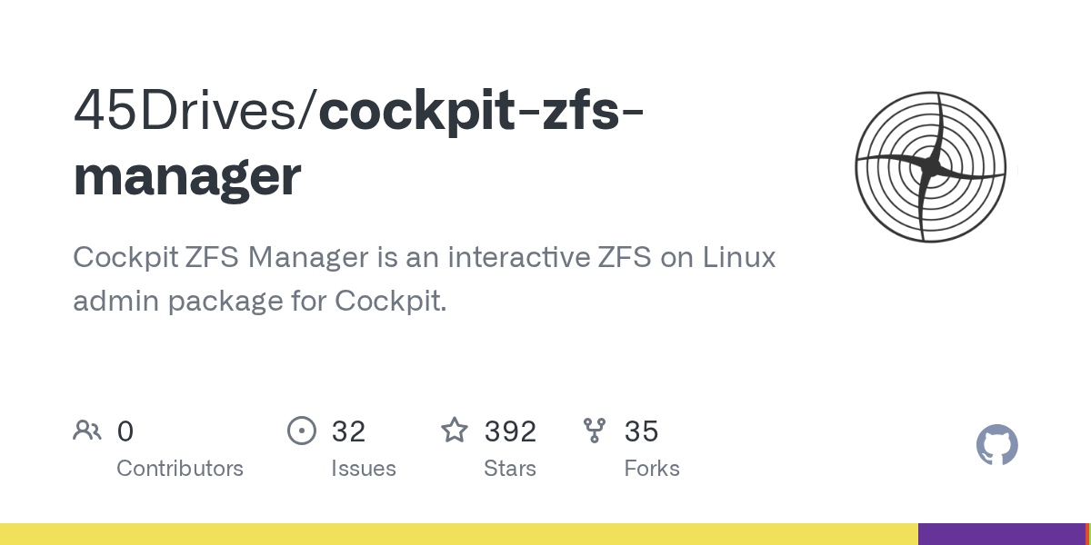

Not MDADM, but a couple options I’ve seen:
The package Cockpit, from Red Hat, can work with ZFS or / and Gluster.
The Gluster looks like the kind of thing you might like:
But the ZFS module for Cockpit, does Similar for ZFS.
after installing cockpit from the APT repositories, grab the github for 45-drives, and remember to change the github to the 45 drives page, not just copy-paste the Optimans one, like 45 drives instructions tell you to…
Forum thread about it:
