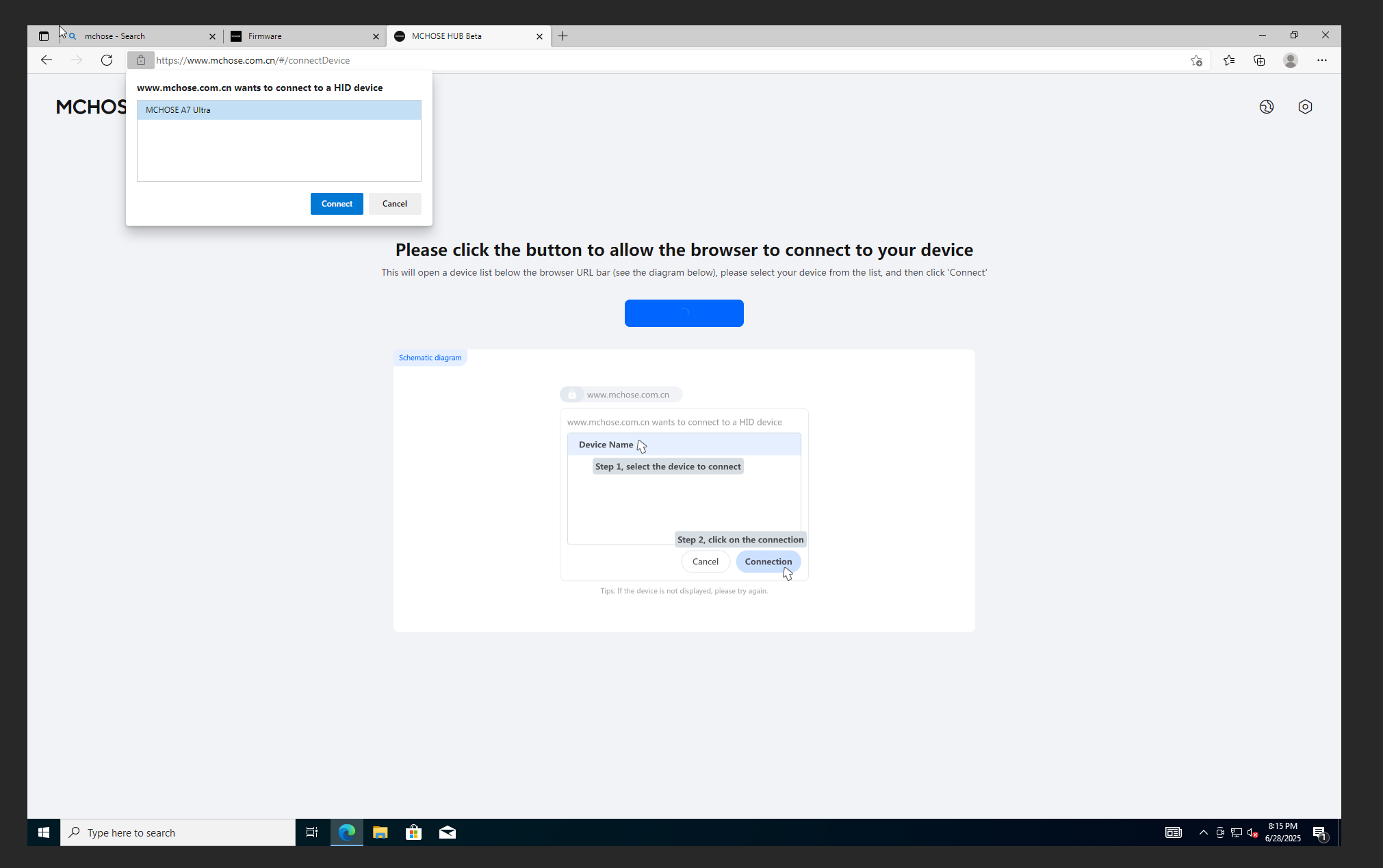

Web UI is accessible on linux using chromium (requires setting write flag on usb device).

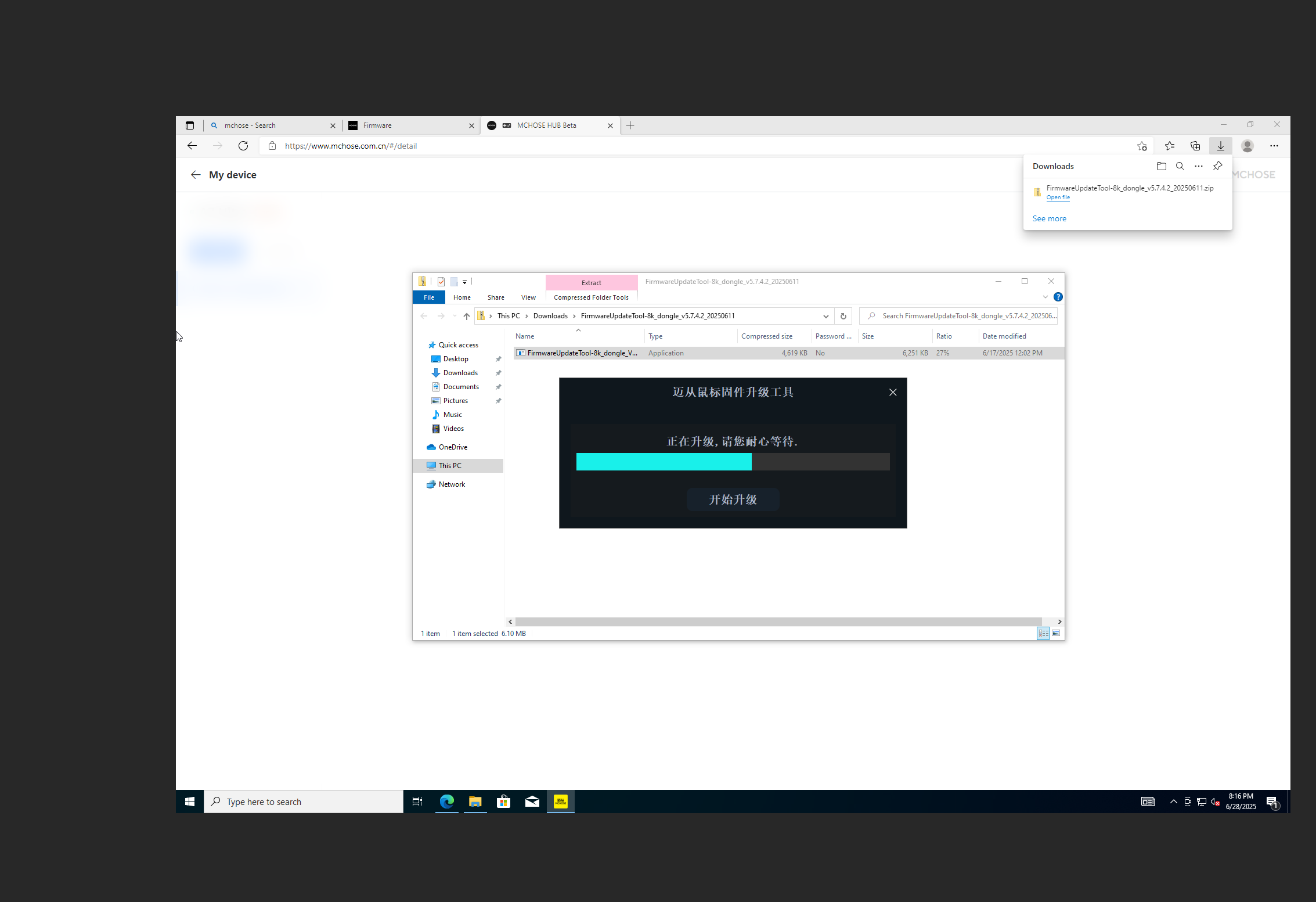

Updating dongle/mouse firmware requires running EXE, so I’ve had to update it using VM.
Web UI supports English (pic from VM, but it works on linux as well)
Firmware updater not so much (but it has a single button, and I’m brave)

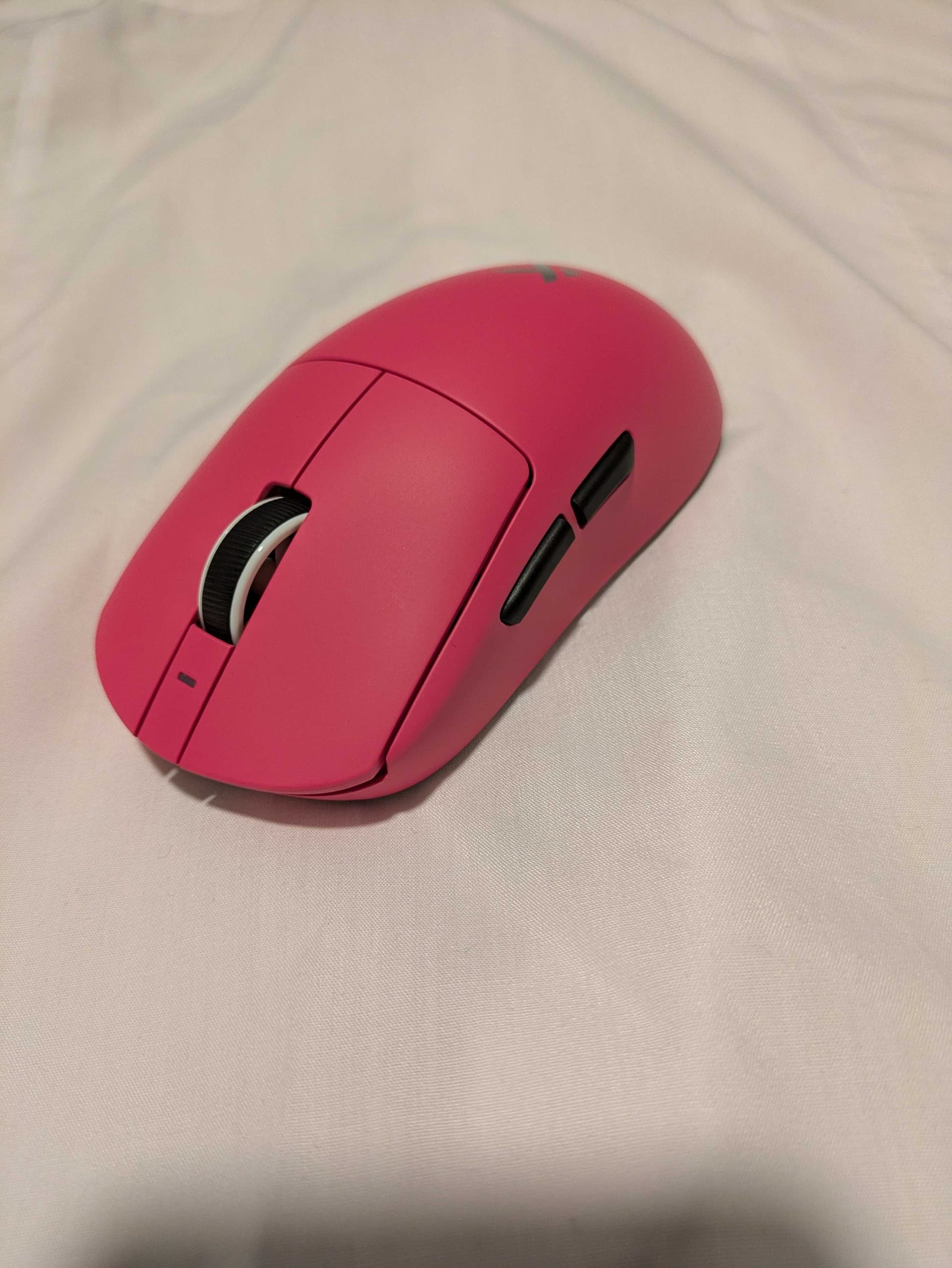

Seems like a crime to write a review of a mouse without a picture of one. Please post one?

I didn’t post one because that’s easy to find online :joy:
In the spirit of making questionable choices I went for the most in your face offering

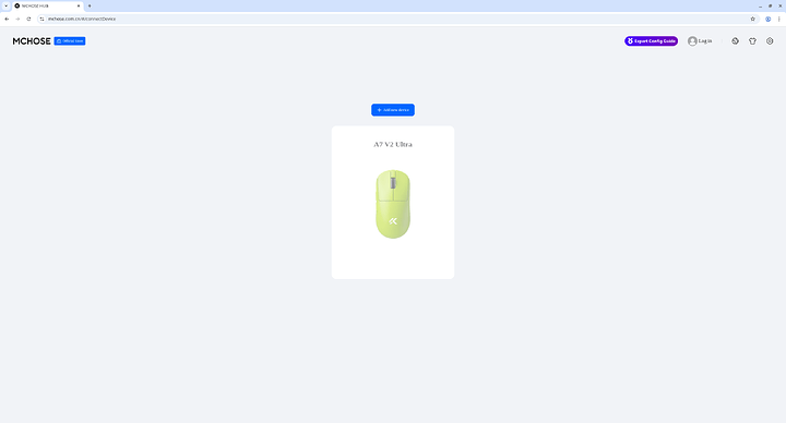

Hi there,
I just got this mice but having some issue with connecting it with WebGUI. For some reason the mice stays greyed out on the GUI and I cannot do anything:
I think you mentioned that some kind of WRITE flag needs to be set for the USB device? Can you elaborate on that and perhaps share how you did it?
I am running Arch Linux with KDE Plasma DE. I did update the firmware using windows VM.
Thanks!
For anyone wondering, I followed this:
Open up a terminal and enter lsusb record the relevant vendor and product id for your mouse, my listing comes out as Bus 001 Device 003: ID 3837:100b RealTek MCHOSE A7 V2 Ultra so vendor is 3837 and product is 100b, then
sudo nano /etc/udev/rules.d/mchose-a7-v2.rules
KERNEL==“hidraw*”, ATTRS{idVendor}==“3837”, ATTRS{idProduct}==“100b”, MODE=“0666”, TAG+=“uaccess”
replace the Id’s if they came up different, save with control + o and exit nano. enter the following to the terminal:
sudo udevadm control --reload-rules
sudo udevadm trigger
and you should have access, save this for later if you purchase the mouse.
Thank you very much, this worked perfectly on my Fedora 43 machine :)!
One thing to note when copy-pasting is to replace the fancy styled double-quotes with regular plaintext ones, like this:
KERNEL=="hidraw*", ATTRS{idVendor}=="3837", ATTRS{idProduct}=="100b", MODE="0666", TAG+="uaccess"

Hey UNinaMe, thank you for this post! I’m having the same issue with my MCHOSE L7 Pro on Nobara Linux 44 / KDE . I did apply the steps you mentioned in your reply, however I still can not access the web driver (grayed out ui like you described it before). I did change the IDs to my device specific output (**lsusb). Im quite new to Linux / Nobara, is there anything I’m missing here?
