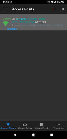

I picked up some of the Engenius Fit APs based off of @wendell recommendation and I’m trying to match my current Unifi settings so that I don’t have to redo all of my devices. But I can’t seem to get them to match. My Unifi setup is WPA2/WPA3 and shows like this in Wifi Analyzer.

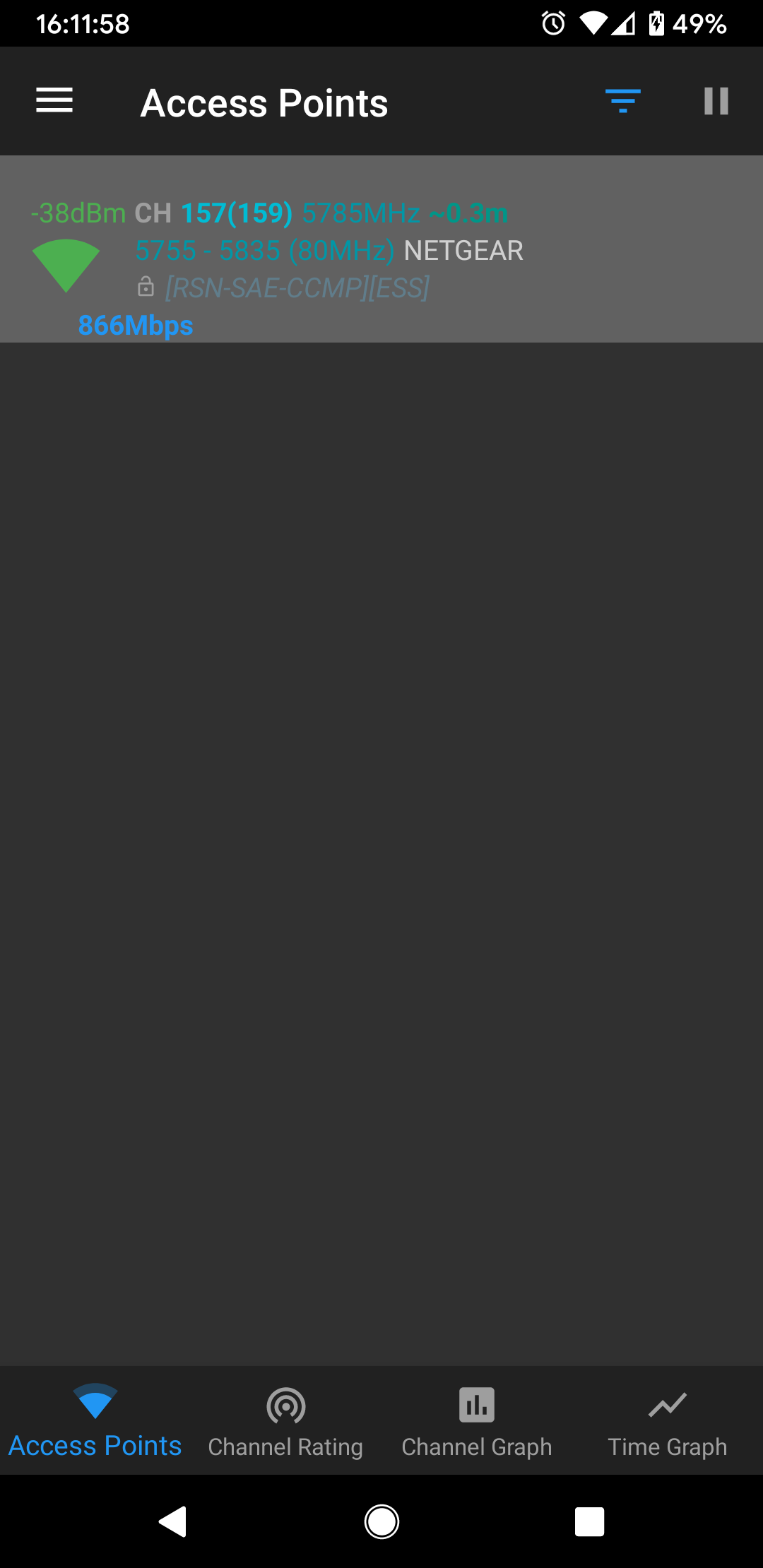

If I select WPA2/WPA3 in Engenius, I get this.
The closest I can get to matching the Unifi settings is still missing the +SAE and that’s using WPA2-PSK.
