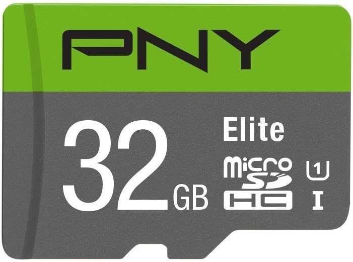

So a month ago I got a fast 32 gigabyte SD card so that the 4 gigabytes of internal memory wouldn't be bogged down and I could have all my music on my phone. Now cut to about 4 gigs being used on the card, and now whenever I try to transfer apps to the SD card it claims it doesn't have enough storage, and reformatting would be hell, so do you guys have a better alternative to my problem?

Bought it from Staples,
My problem lies in the fact that I set up the SD card as internal storage, and whenever I try to transfer apps it just goes fuck you. Now I something of a theory to why, but it's existence would delimit from my phone, I have about 3 gigabytes of MP3s on there, and they are all in downloads, and maybe Android is looking at the file system and reading that the storage is full.
