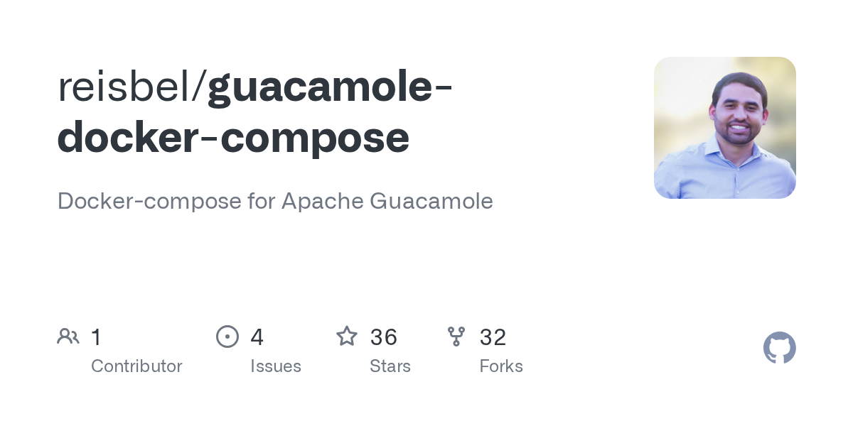

Also, I would suggest using docker-compose to manage your containers. docker run is fine for testing or development, but for using over a long period, docker-compose has much easier updates and has built in documentation of what options you setup the container with.
I have a guacamole instance using the docker-compose template from here-
