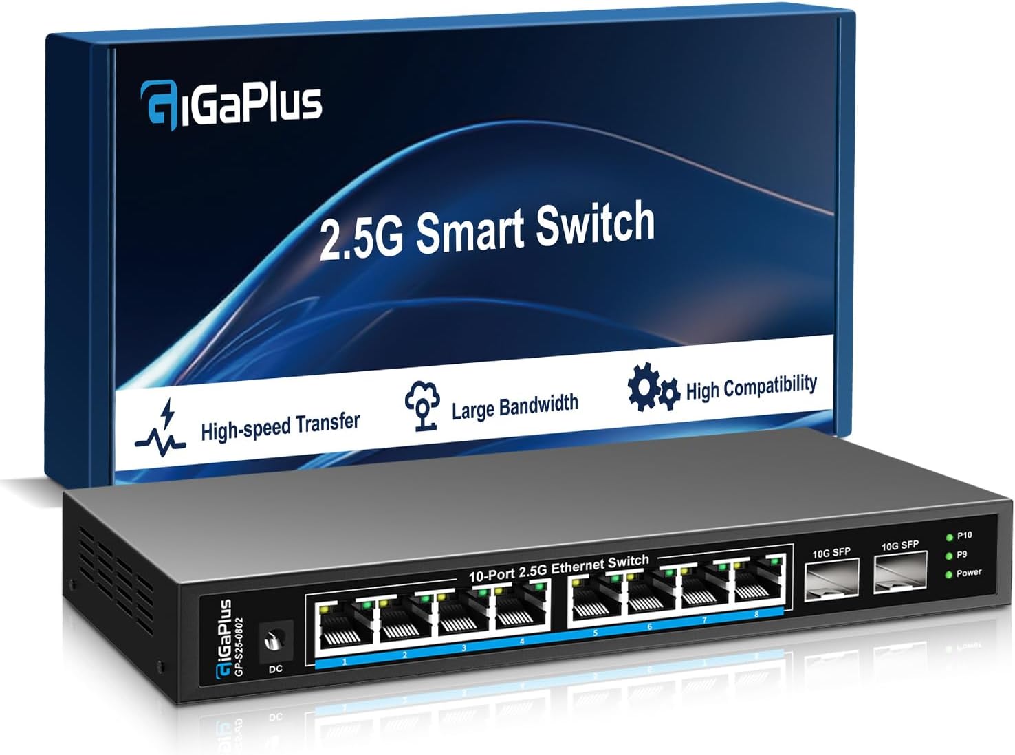

As a cheap sort of “we dont want to spend time managing and setting up the network, just want to plug it in and work” type of network switch that will let you use all the high speed stuff Id go with this:

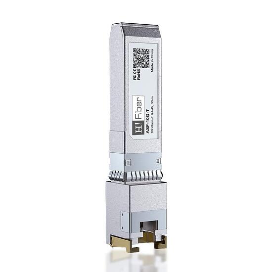

and one of these for connecting the switch to your router:
It gets you 8 ports of 2.5gb for your PCs, plus a 10gb connection to the router, plus an extra 10gb connection to the server or NAS. This was tested by ServerTheHome as a recommended switch in its class, and uses little power with only 2.0W idle and 0.6W per 2.5GbE Port
