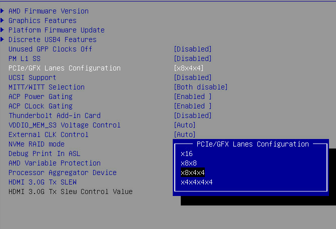

Would you mind to list the available bifurcation options for this board? I am wondering if the PCIe slot can be bifurcated to x4x4x4x4.
My intended use would be 5 U.2 drives and 1 25Gbe Nic. Therefore I was thinking about:
2 U.2 via MCIO 1
2 U.2 via PCIe 5.0 x8 to MCIO 8i adapter (in the physical x16 slot of the board)
1 U.2 via MCIO 2 (leaves one M.2 active)
1 25Gbe via M.2 to PCIe 5.0 x4 adapter
The “Slot” is the physical slot and the last 8 lanes can be assigned to the MCIO port. So I use x8x4x4 to get 8 lanes for the NIC in the slot + 2x U.2 for MCIO.
Fairly easy and plug&play. Don’t know how x4x4x4x4 works, as I only ever used my config.
bifurc
