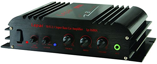

That of corse don’t come with the receiver which you will need to buy separately to power the system. Somthing else you could do which I'm doing right now and it sounds pretty good is buy a 2.1 system and expand out. You could do somthing like this.
https://www.monoprice.com/product?p_id=8250
Then buy speakers wire to connect it. Then when you have the money buy a good receiver and start upgrading the speakers or expanding out to 5.1
