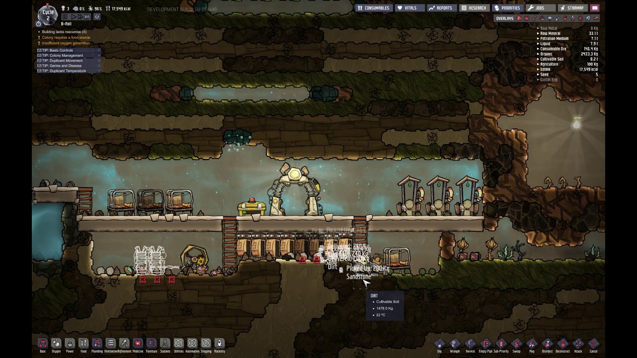

In troubleshooting, Iā€™ve tried KDE now since it allows compositing to be disabled, but it originally had the same flashing issue. However, here is something strange to note; the problem appears to be unpredictable. Sometimes I get the flashing issue, sometimes I get nothing but a black screen, and sometimes it actually works and I get a stable screen display (OMG the response, incredible work). This now holds true for both KDE and Gnome 3. Given this behavior, I tend to think that perhaps the compositing is not the only issue? I can achieve a stable display in Gnome 3 even with compositing defaulted to ON. I just wish it was more predictable! Iā€™d say on average I have to launch and kill the client about 6-7 times before I get a stable display. Once stable, it stays that way until I kill the client and start it again. At that point, I just keep killing and launching until it comes up stable again. Interesting.
Please try without AMD pinned memory:
-o opengl:amdPinnedMem=0
Bravo, sir. Consistently performing perfectly now. Thank you!!!
