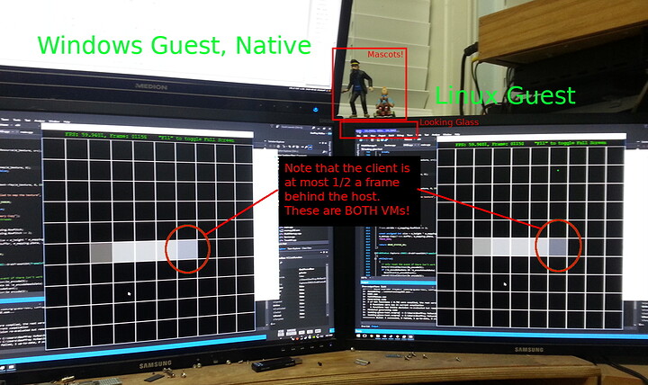

Edit: A kernel module has also been added to allow VM->VM communication.
I am pleased to announce that VM->VM performance is now fixed, if you want to run using this method you need to load the kernel module for the IVSHMEM device otherwise your performance will be terrible.
Getting very close to an A11 release, most outstanding issues have been resolved including a License incompatibility issue with OpenSSL preventing project packaging. As such the dependencies have now changed, instead of libssl-dev you now require nettle-dev and libgmp-dev to build the current unstable version.
The current state of VM to VM sync:
The client just got UNIX socket support for lower latency input, to use specify the port as 0 and the host as the socket, ie:
./looking-glass-client -P 0 -h /path/to/socket.sock
This is fixed:
https://www.patreon.com/posts/vm-vm-with-is-18936084
