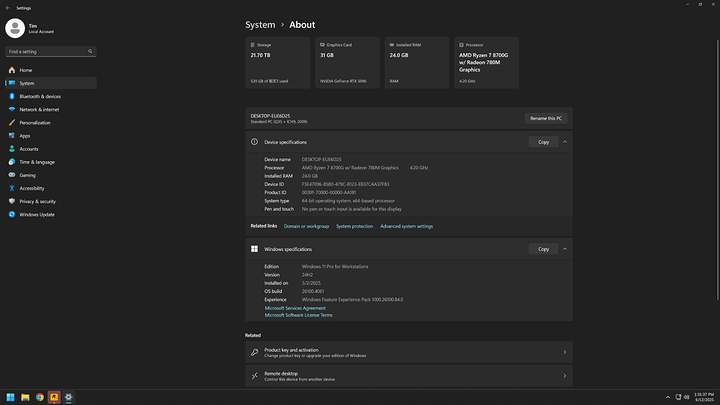

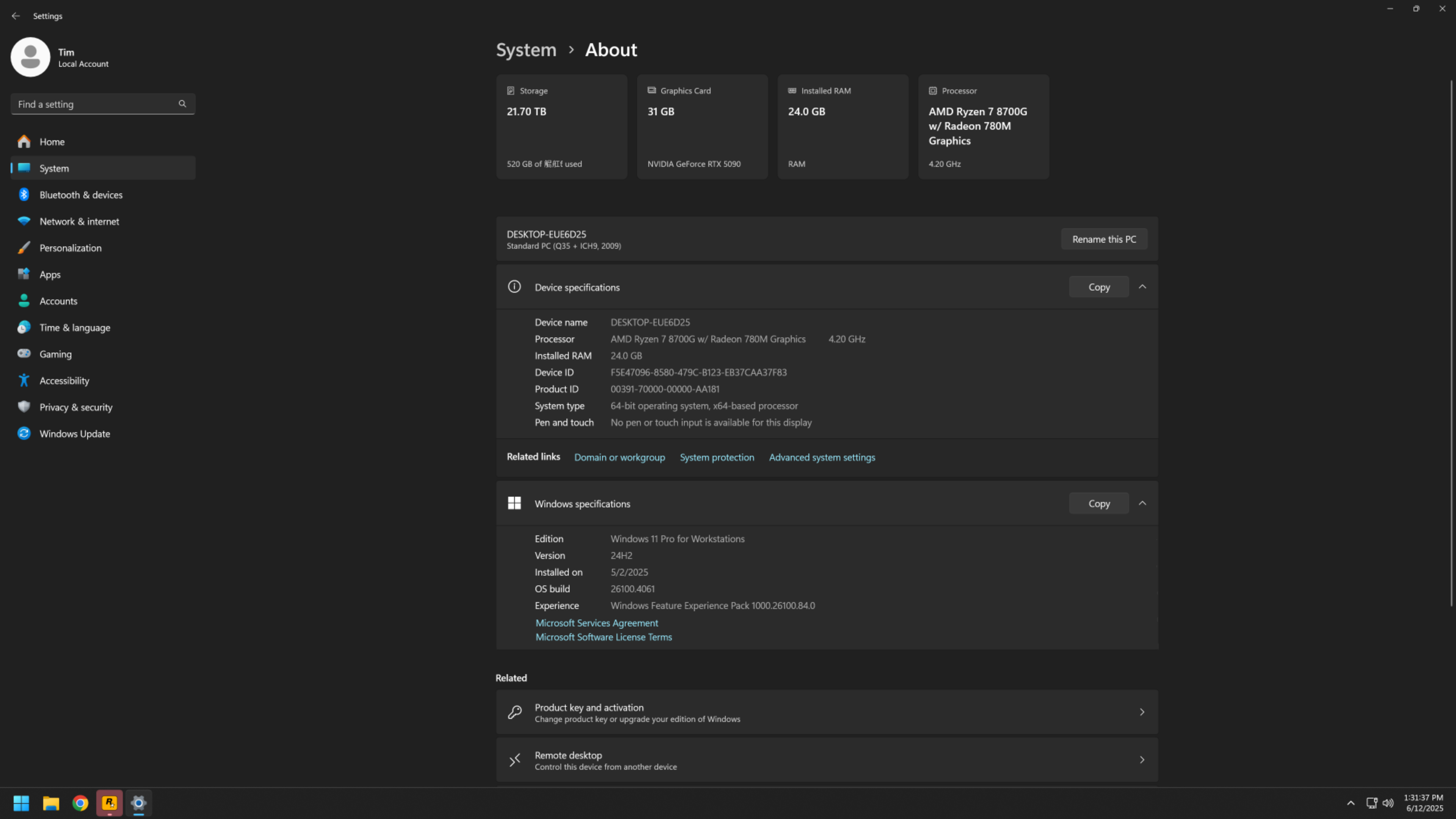

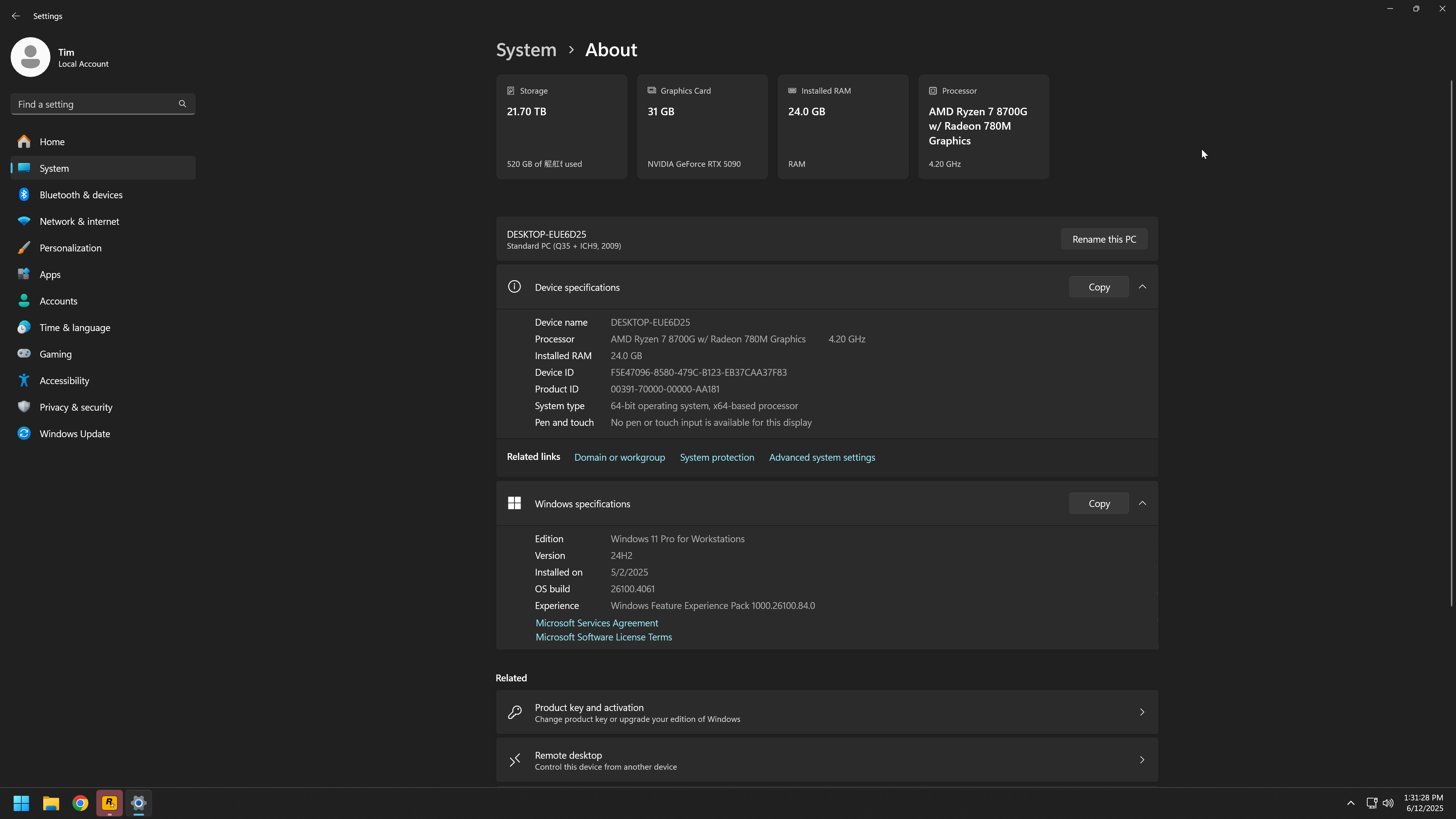

I have used looking glass without any problems for quite a while, until today. I noticed that when looking glass is on my middle monitor, it becomes incredibly blurry, while if it is on my other screens, it looks crisp. All my monitors are 4k, including the guest os, however my middle screen is 144hz, so i want to use my middle screen with looking glass, like i have been doing for ages.
The most annoying part is i did not change anything since yesterday, just shut down my pc yesterday, booted it up today, and now only on my middle screen looking-glass is blurry. A reboot did not help, neither did unplugging everything and plugging everything back in again. I don’t have a clue what could have caused this, so i don’t really know what i should even share when it comes to debugging info. At this point i am mostly just curious if anyone else has run in to this issue before, and if so, what they did about it (if anything).
I have attached 2 screenshots below for reference. The only difference between them is that i moved the looking glass window between monitors, and in one it looks very blurry, in the other it does not.
