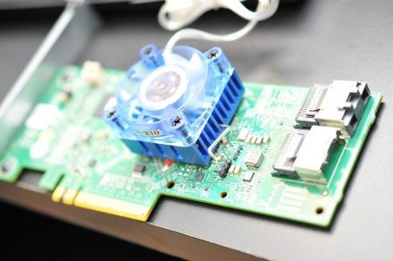

I’ve got a 40mm Noctua zip tied to the heatsink. Keeps it cool even at low RPMs.
Dell h310, IBM 1015M and similar cards will also work in a desktop, but are designed for high airflow servers, hence having just a heat sink without fan.
A small fan like Zavar suggested would work.
(Or a larger fan if that is what you have, but that would be wasteful/no extra benefit, apart from maybe already being available)

Ooh, that is why mine keep dying… I’m going to go zip tie one on.
