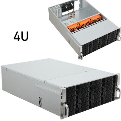

Sure thing!
Comes with the chassis I intend to purchase. However, I did find the “non-name” brand that makes these and they did not have anymore information than what I found here with the listing:
