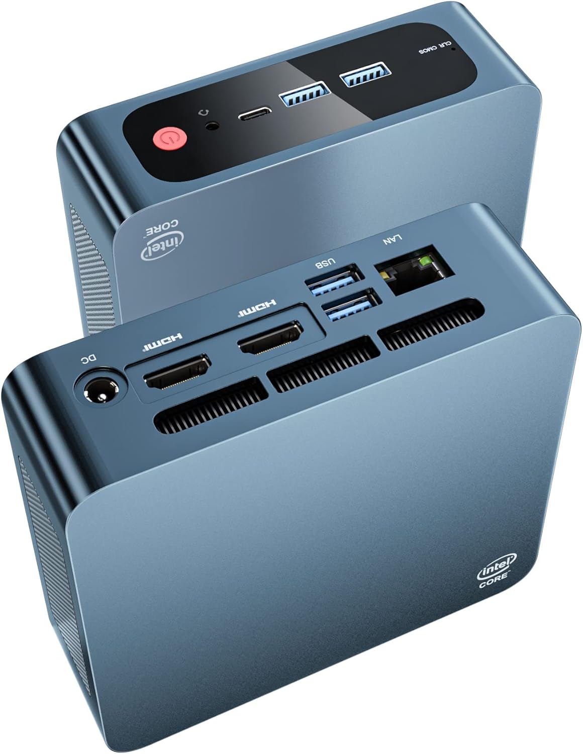

In regards to your recommendation, would this PC be good enough?

What is the general opinion of this particular device:
You might want to look up aftermarket support (BIOS etc) and I would think twice about both the CPU and Realtek NICs.
If that doesn’t bother you the UP Squared V2 boards might be of interest.
What the issue with the CPU?
Are Realtek NICs really that bad? I mean maybe a Realtek NIC won’t handle GbE, but it should come very close? I’m asking because most NICs are Realtek as far as I can tell and I think driver support in OPNsense and pfSense probably has improved, hasn’t it?
Realtek NICs are bad in general (but they’re cheap) so your milage may vary, I haven’t touched Realtek NICs in FreeBSD for years and just gone with Intel because it works ™. That’s what also Netgate recommends looking at Hardware | pfSense Documentation . Other brands such as Chelsio are also well regarded by that’s another tier…
Realtek is not great, but common enough to probably work.
ASIX is really bad (and dirt cheap).
Intel, Mellanox, etc. are the good ones.
I find it kinda overkill, but for the price ($134), it’s a steal! I think you can go for it. What I’m afraid though is that it may have Realtek NICs, which is… fine, they work, but I tend to avoid them, because many times, they do not have drivers in BSDs, or they have wanky bugs that make them stop working or have their performance plummet after a certain period or a certain number of packets. All kinds of crazy stuff.
But on my Asrock J3455M, I did use the Realtek in-build NIC as a WAN and it worked fine, while using the PCI-E HP 4x Gigabit Ports Intel chipset card for my LAN. I was running pfSense and got that chip because it had AES-NI, at the time when pfSense was saying that 2.5 will have a hard requirement on it (I started with 2.4). It never actually happened and it took a long time before I realized my OpenVPN was not even using AES-Ni, it was using the CPU and was working flawlessly. Later on, I did enable it in the settings, but I wasn’t aware it was a opt-in toggle. Basically free performance for encryption stuff, you do stuff at the cost of less power.
They might be charging an arm and a leg for the that, just because it’s a rack mounted low power Atom (which the Celeron also technically is, the Gemini Lake is the Atom core lineup - but don’t get me wrong, those things can trade blows with old i3s and keep up with old i5s at only 1/10th of the power consumption).
They should, just that depending on what you get, you may have weird bugs, like mentioned above, or not work at all because of complete lack of drivers.
